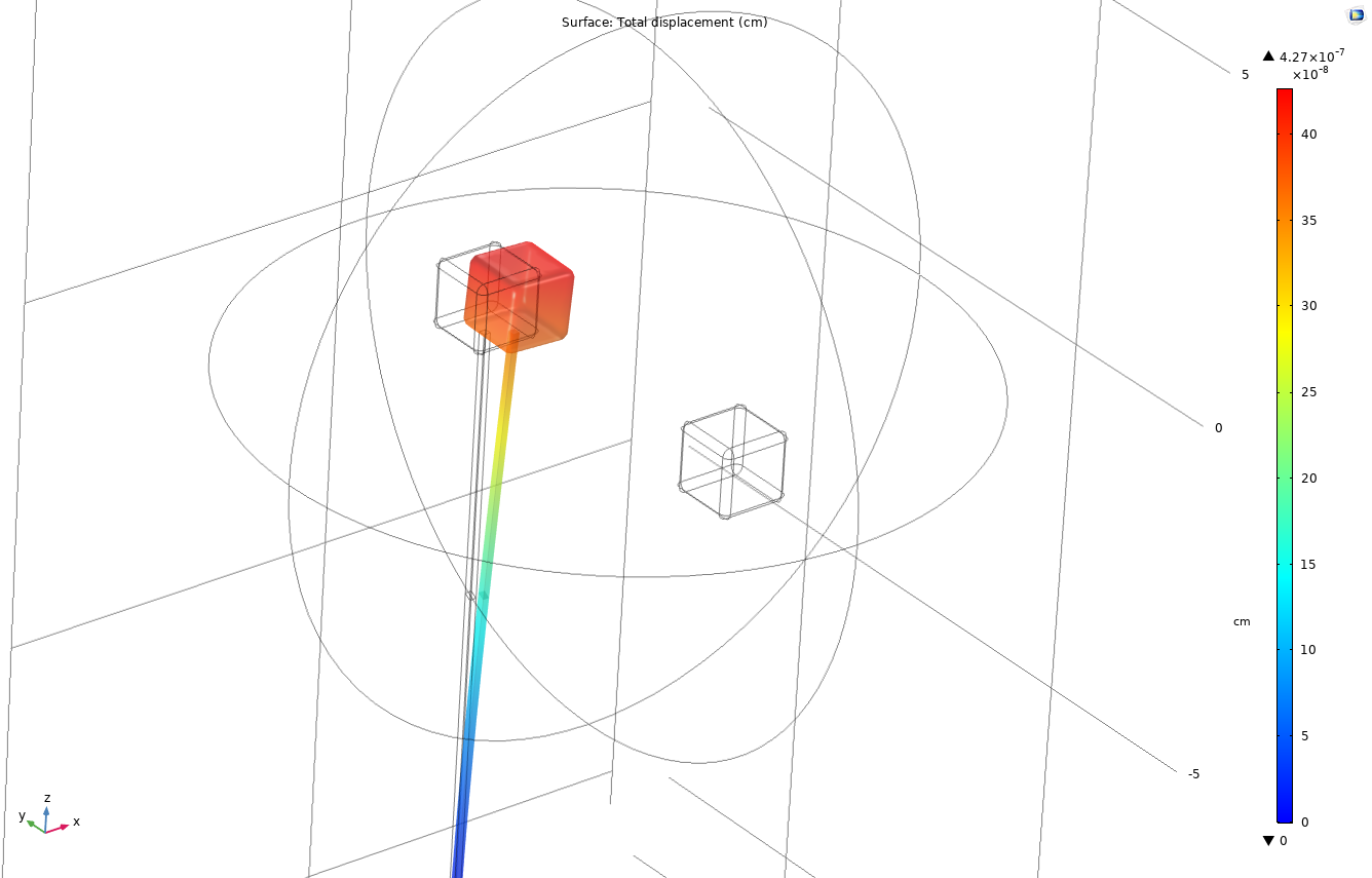

Your model only has a mesh for the mechanical aspects. The mfnc physics requires a mesh to contain the whole model problem (unlike mechanical models, magnetic models require a domain defined that contains the whole problem and within which the magnetic solution can be calculated).
I would suggest you build a very simple magnetic only model to understand the intricacies of obtaining accurate force results for 2 magnets (hint: use fillets on all edges and define a very fine mesh on the boundaries of the magnet domains).
The attached may be a good starting point. As Force is calculated with the Maxwell stress tensor, it is VERY mesh dependant, and the sharp edges on the attached model are also not desirable (use fillets).

Hello Mark,
First thank you for your quick reply!
Unfortunatly I don't have the 5.6 Version. Only 5.5, maybe you can downgrade your file and attach it again?
I tried now to do the fillets on the magnets. But still the dispalcement of the Magnet 1 is in a strange direction. Also if I change the vector of the Remanent Flux Direction from 1 to -1 for the y-component only the magnitude of the displacement is slightly changing, not the direction.
Thanks for your help,
Christopher
