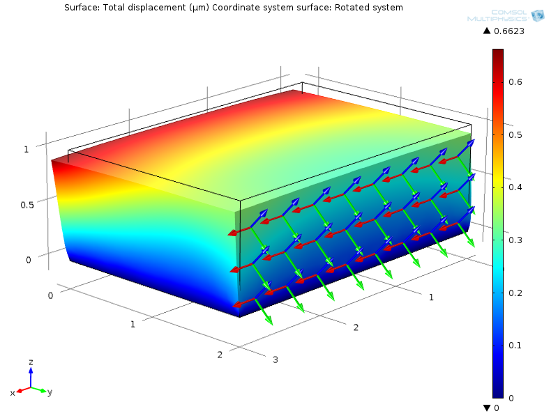

Posted: 1 decade ago 18.06.2012, 09:11 MESZ
I believe I start to see your issue ;)
If I do a simple block model in 3D I can orient a Rotated system in 3D (with the Euler angles (0,-42.75°,0) and get your image vector orientation, with the electrodes in the X-Y plane at two different Z height locations. Then I can get a 3D X-Z plane (corresponding to your 2D x-y SAW plane) and see the PZT deformations.
this gives you strain matrices elements, in the local coordinate system, of the type
pzd.el11
(sys2.T11*uX+0.5*sys2.T12*(uY+vX)+0.5*sys2.T13*(uZ+wX))*sys2.T11+(0.5*sys2.T11*(uY+vX)+sys2.T12*vY+0.5*sys2.T13*(vZ+wY))*sys2.T12+(0.5*sys2.T11*(uZ+wX)+0.5*sys2.T12*(vZ+wY)+sys2.T13*wZ)*sys2.T13
But now to remap this into 2D with a 3D Rx rotation for a material plane coordinate system, I cannot find the COMSOL commands, and referring to "z" or "Z" in 2D brings an error message Z unknown
And the then the local strain matrices are
pzd.el11
(sys2.T11*uX+0.5*sys2.T12*(uY+vX))*sys2.T11+(0.5*sys2.T11*(uY+vX)+sys2.T12*vY)*sys2.T12
missing all coupled "Z" terms
So probably you need to write out manually the coordinate mapping in 3D and use that in 2D. But you can be inspired by the 3D model.

Hi I believe I start to see your issue ;) If I do a simple block model in 3D I can orient a Rotated system in 3D (with the Euler angles (0,-42.75°,0) and get your image vector orientation, with the electrodes in the X-Y plane at two different Z height locations. Then I can get a 3D X-Z plane (corresponding to your 2D x-y SAW plane) and see the PZT deformations. this gives you strain matrices elements, in the local coordinate system, of the type pzd.el11 (sys2.T11*uX+0.5*sys2.T12*(uY+vX)+0.5*sys2.T13*(uZ+wX))*sys2.T11+(0.5*sys2.T11*(uY+vX)+sys2.T12*vY+0.5*sys2.T13*(vZ+wY))*sys2.T12+(0.5*sys2.T11*(uZ+wX)+0.5*sys2.T12*(vZ+wY)+sys2.T13*wZ)*sys2.T13 But now to remap this into 2D with a 3D Rx rotation for a material plane coordinate system, I cannot find the COMSOL commands, and referring to "z" or "Z" in 2D brings an error message Z unknown And the then the local strain matrices are pzd.el11 (sys2.T11*uX+0.5*sys2.T12*(uY+vX))*sys2.T11+(0.5*sys2.T11*(uY+vX)+sys2.T12*vY)*sys2.T12 missing all coupled "Z" terms So probably you need to write out manually the coordinate mapping in 3D and use that in 2D. But you can be inspired by the 3D model. I find it worth to send off a mail to support to have them explain to you how they considered this, it seems a bit strange that you cannot define a full arbitrary 3D coordinate mapping for PZT materials in a 2D model -- Good luck Ivar
