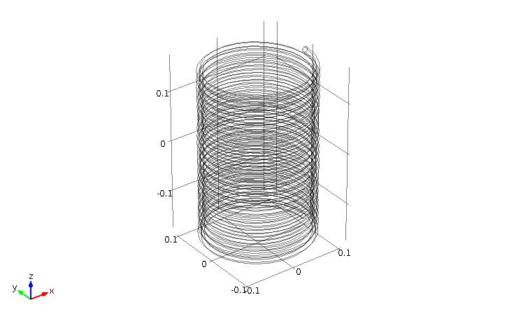

We are working on a 3D multi turn Helix model (as attached) with following parameters:
Number of turns (N) = 24
Current (I) = 50 Amps
For current density we are using the formulae:
Jx = J*y*sqrt(x^2+y^2)
Jy = J*x*sqrt(x^2+y^2)
where J = N*I/A
Here we know the values of N and I, but we are confused on what to use for the value of Area.

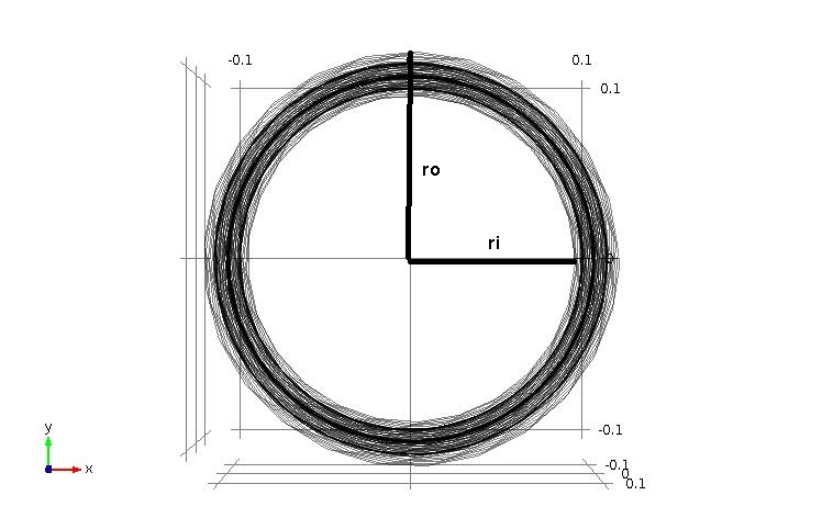

We believe it should be:
1. A = pi*ro^2 - pi*ri^2 (where ro = outer radius and ri= inner radius as shown in the figure Top view)
or
2. A = pi*r^2 (where r = radius of the coil)
It would be great to have your guidance.
Thanks
Uttam M. Pal

Thank you for your response. I can find myself better now.
We are using Comsol 4.2a in 3D, Cartesian coordinate system. We have tried with 2D Axi symmetric model and it is matching with the experimental results.
I would like to rectify my errors and hence the correct form (of the helix) is:
Jx = J0*y/sqrt(x^2+y^2)
Jy = -J0*x/sqrt(x^2+y^2)
Where J0 = N*I / A, where A is the cross sectional area of the wire (not the coil) = pi*r^2, where r is the radius of the wire. N being the no. of turns and I is the current (Amp).
In experiment we are using N =40, but due to computing constraint, we had to use N =24 in 3D simulation.
The difference between the simulated and experimental B Field flux density is around 3-5 Gauss, would it be because of the no. of turns which we had to choose less because of the constraint of computing resources?
Thanks.
Uttam M. Pal
