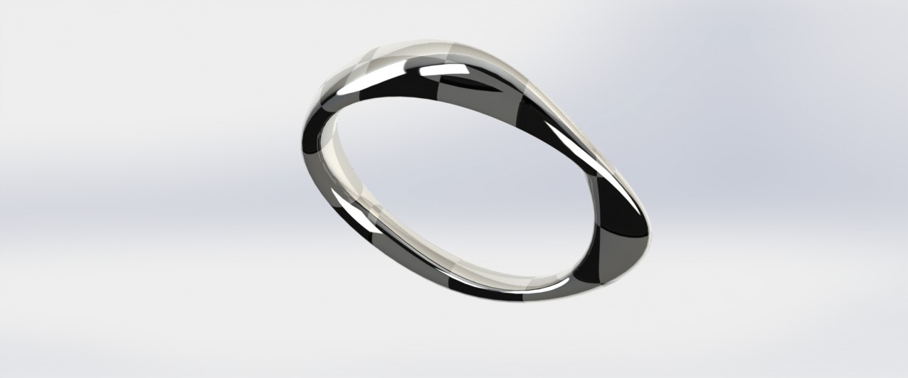

Well the whole concept of a Mobius strip *is* that it has only one side. The Parametric Surface way gets us to a domain that indeed is three dimensional and has only one face. It is very interesting in seeing how Comsol treats that, since one of the traits such a strip has is that it is has no direction topologically, if I am not mistaken.
anyway, I managed to import it to comsol with a ".x_t" file eventually; can't attach the file I imported, but attached a picture.
I tried to simulate something very very easy and light with it, and it started getting lengthy already, so I let it run for the night. Tomorrow morning we'll see what's going on.
Well the whole concept of a Mobius strip *is* that it has only one side. The Parametric Surface way gets us to a domain that indeed is three dimensional and has only one face. It is very interesting in seeing how Comsol treats that, since one of the traits such a strip has is that it is has no direction topologically, if I am not mistaken. anyway, I managed to import it to comsol with a ".x_t" file eventually; can't attach the file I imported, but attached a picture. I tried to simulate something very very easy and light with it, and it started getting lengthy already, so I let it run for the night. Tomorrow morning we'll see what's going on.
