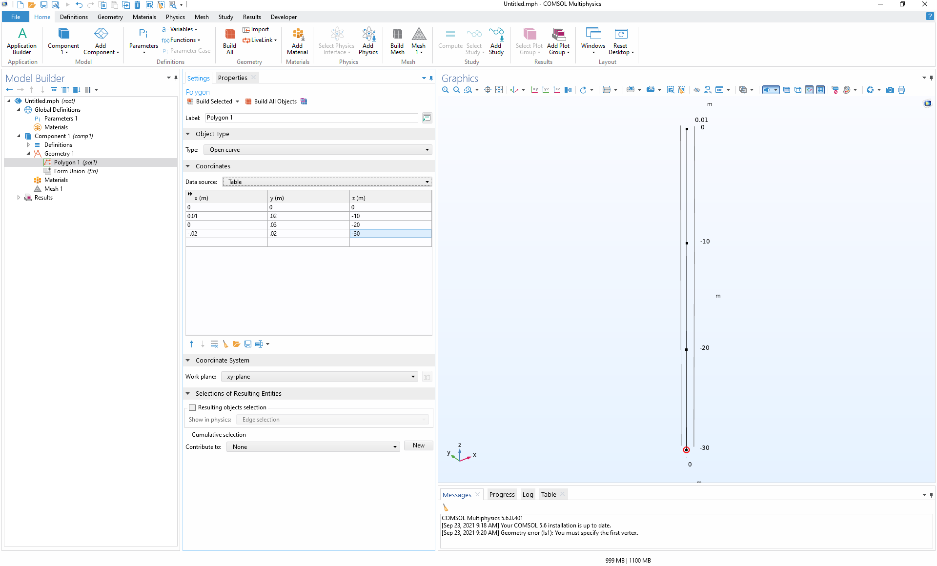

While there are ways of reading plain-text file data into COMSOL, there is no one-step way of bringing in a deviation survey and turning it into the sort of geometry feature you are hoping to generate I am afraid. Either of the two approaches I suggested earlier remain valid alternatives. With that said, there is one more idea that came to my mind and it may well be simpler for you to implement: if you can massage your data so that instead of being a list of depth, inclination and azimuth it is a list of (x,y,z) coordinates -which should be a matter of simple trigonometry- then you could import that directly into a Polygon. In the attached screenshot, I typed such coordinates manually into a table but another option is to read those coordinates from a file.
