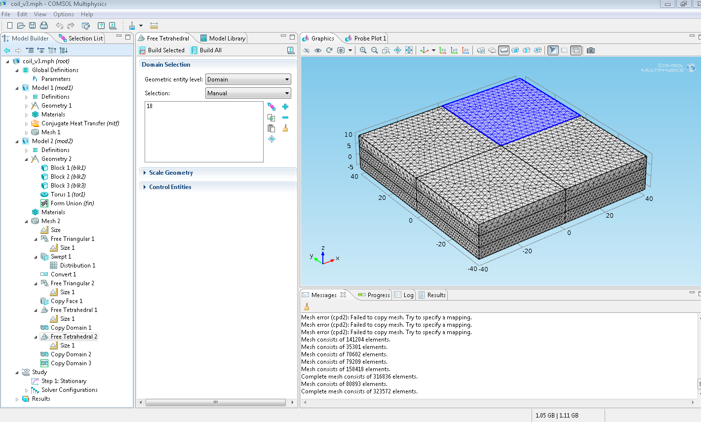

Thanks for your advice again....especially for how to split volumes into multiple pieces.
I did what you recommended (splitting the air into 3 parts and increase mesh density) but my model still does not converge.
I looked at the screen capture you provided and it looks like your mesh is much more sophisticated than mine. Am I correct? How did you go about making your mesh? Or is the standard meshing that I used fine? I have attached my model again.
Thanks!
Any other thoughts on why model is having an issue converging? I have attached it again. I feel like it's either a mesh issue and/or some boundary condition.
