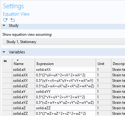

Dear Dr Sönnerlind, many thanks for your reply. Sorry I still don't get it completely. Does switching on/off 'force linear strain' not affect the defined variables in the 'equation view'? If it takes effect depending on the study step, the effect/difference should be reflected from the defined variables, otherwise there's no difference to the equation solving.
Yes, it takes effect in Equation View. If you look at the expressions for the strain variables you should see it, given that Show equation view assuming points the the intended study step.

Many thanks, but as far as I see under 'linear elastic material', when checking or not checking 'force linear strains', the x strain is always solid.el11=solid.eXX=uX.
Difficult to tell, it definitely changes on my screen (as long as I am pointing to a geometrically nonlinear study step).
