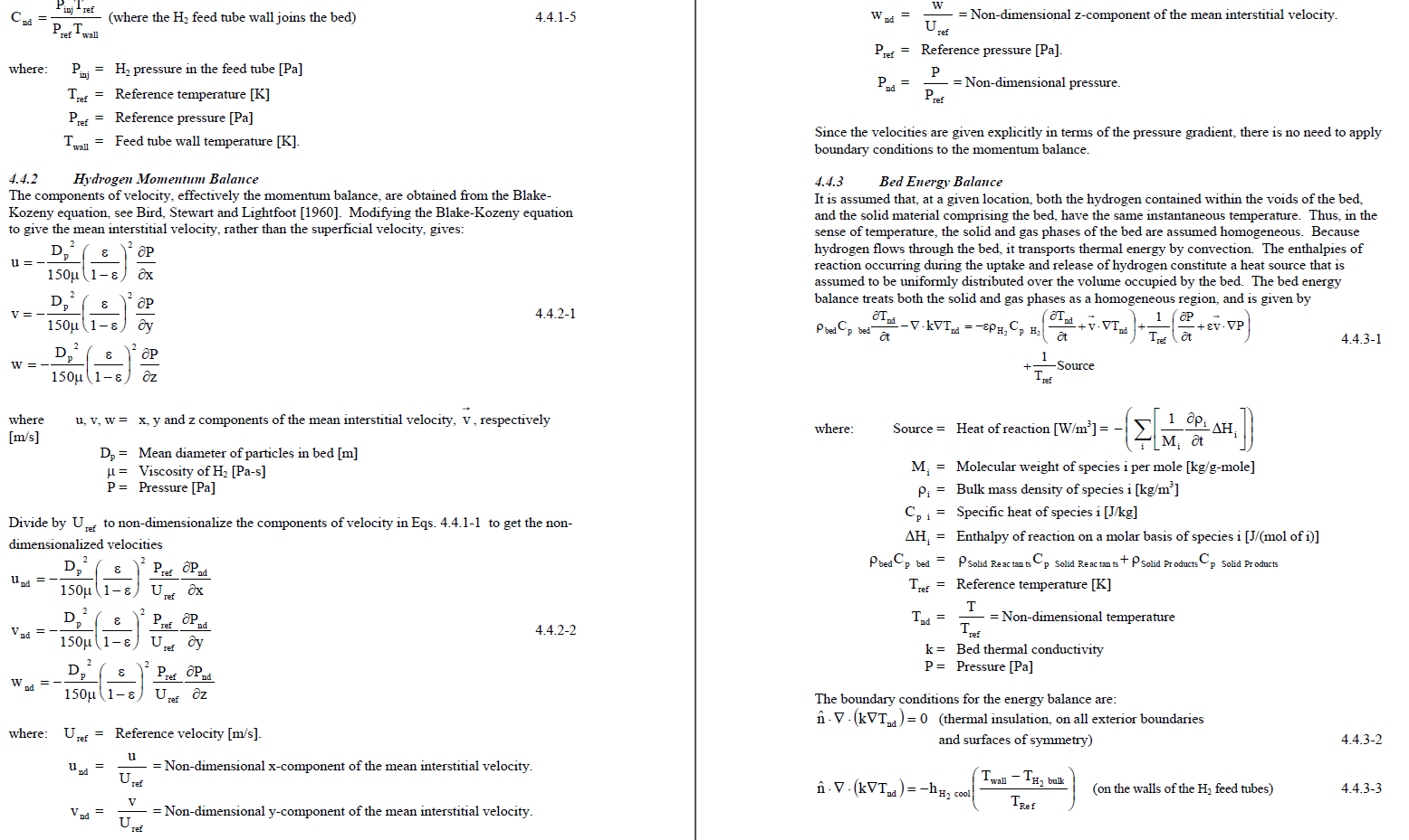

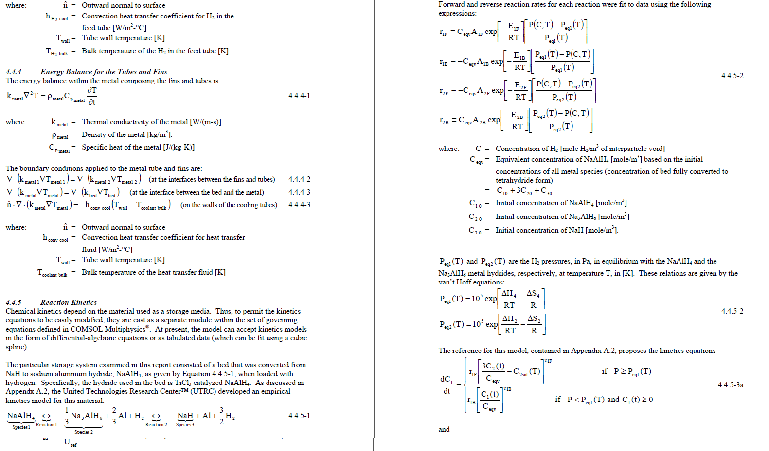

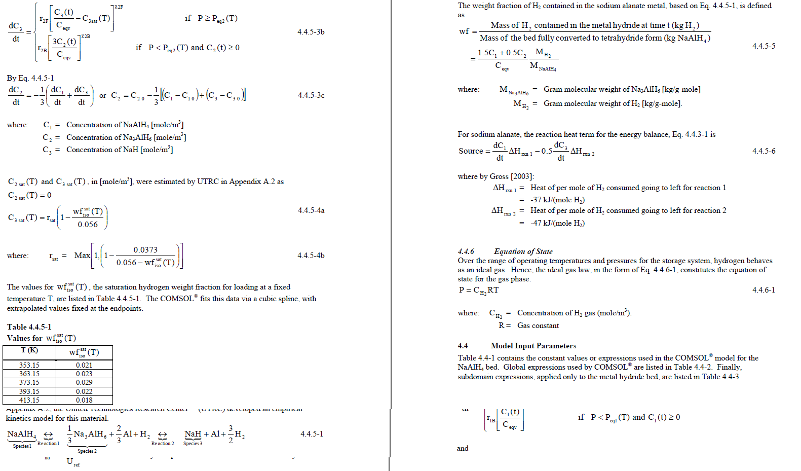

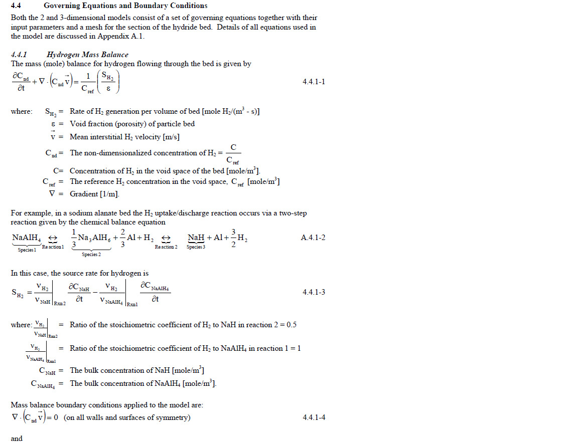

I am trying to model a material using a simple geometry (donut with cooling on the exterior and hydrogen delivered at the interior). This model will couple conservation of mass, momentum, energy and chemical kinetics in one shot. But the form of the equations don't seem to mesh with the selectable physics in the menu. Attached is a document that addresses the physics used in COMSOL previously as I am trying to verify results, but I am struggling to put the equations into the program. The relevant pages in the pdf file are 24-35 under model description. Does this mean I need to use the pde option using the common form and just add in the equations? Specific equations that need to be added are 4.4.1-1, 4.4.1-3, 4.4.3-1, 4.4.5-3a, 4.4.5-3b, 4.4.5-5 and table 4.4.5-1.

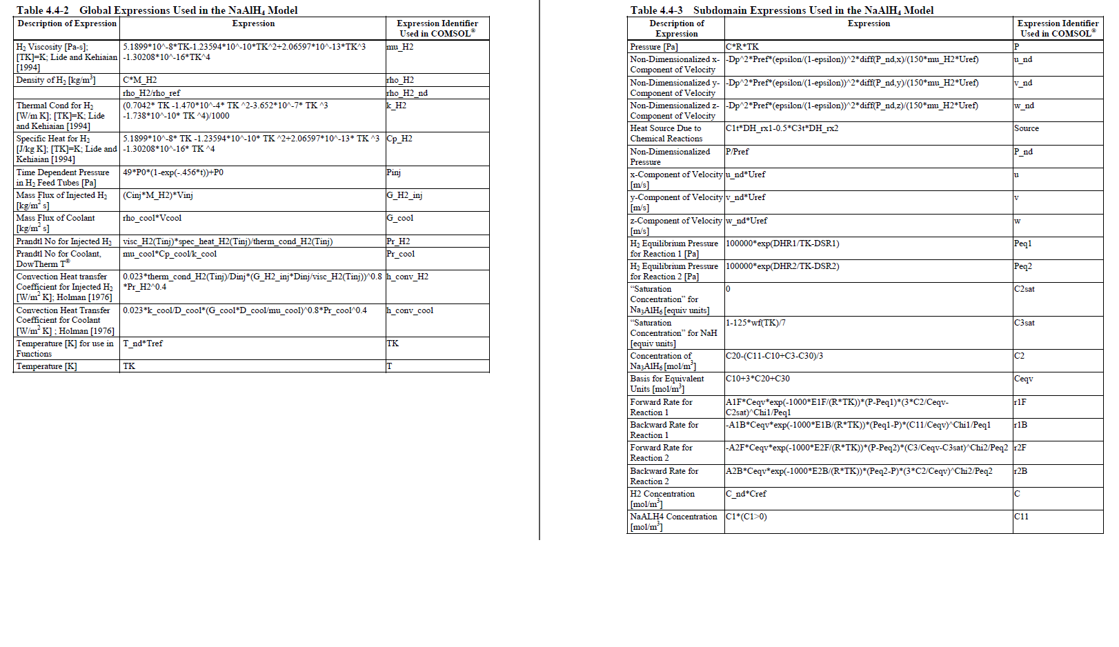

Afterwards are 4 pages of inputs presented for use in the program and shown in one text (.txt) file annotated for clarity and brevity.
The two biggest questions besides the best way to add in the equations are:
How do I put in a cubic spline fit for the data in table 4.4.5-1?
How do I handle the pressure terms in 4.4.3-1, namely adding their physics into the program?
