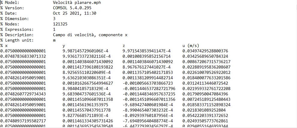

Hi everyone, after working at laminar flow module i got data as shown in picture below, i need to get an equation of velocity field such as u=f(x,y,z), so i suppose to follow this way: 1)first create a table and load the text file 2)using an interpolation function get the equation
The problem arise when i try to load the table, data aren't reported properly in the table, have you some idea, like follow different method or how fix this problem during the loading of a text file in the table module?

I recommend you to use an interpolation function with Data source set to File as this scales better for large amounts of data. If you want to import the data into the model, use the Import button in the interpolation function.

thanks so much it worked. Best Regards.
