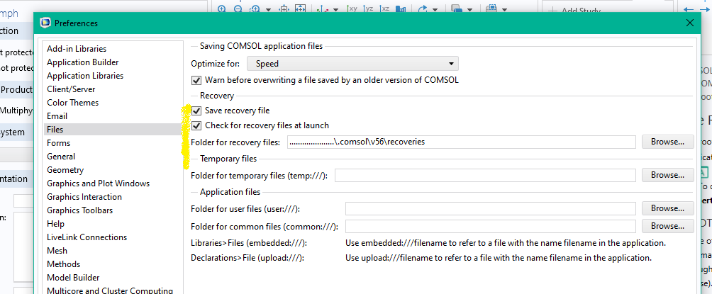

Hi Runzi,
For me the window opens automatically, if there is a recovery file in the recovery folder. Did you check the folder for recovery files?
You can find the path in the preferences under files. Make sure you select the checkboxes "save recovery file" and "check for recovery files at launch" (see picture).
Hope this helps!
BR, Noëlle
Hi Runzi, For me the window opens automatically, if there is a recovery file in the recovery folder. Did you check the folder for recovery files? You can find the path in the preferences under files. Make sure you select the checkboxes "save recovery file" and "check for recovery files at launch" (see picture). Hope this helps! BR, Noëlle

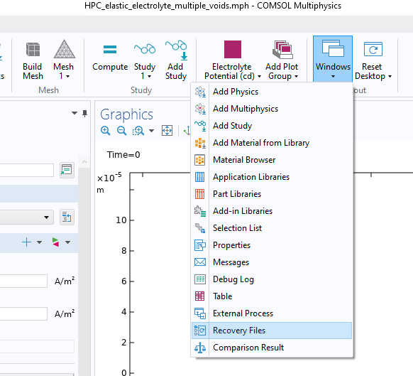

Posted: 4 years ago 09.11.2021, 10:54 GMT-5
Hi Noelle
I found this feature, it is loacted under the 'Windows'.
Hi Noelle I found this feature, it is loacted under the 'Windows'.
