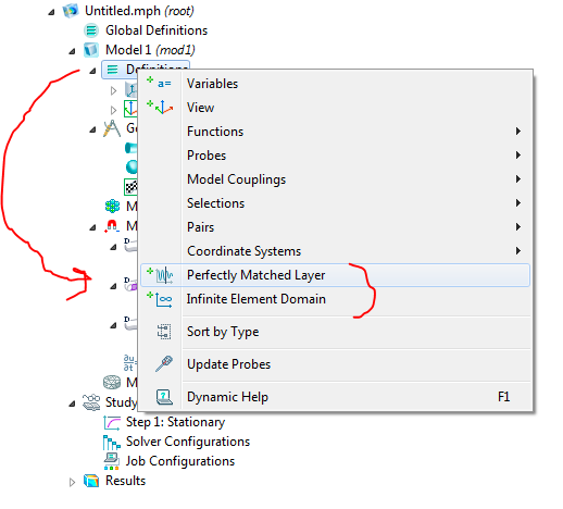

read the doc its in there, some explanations to in the release doc,
In v4.3 all PML has been regrouped to better unify between the physics, they are now defined in the top Model Definition (and not Global) node right-click.
This is a feature I still have not tested in my new v4.3 version
Hi read the doc its in there, some explanations to in the release doc, In v4.3 all PML has been regrouped to better unify between the physics, they are now defined in the top Model Definition (and not Global) node right-click. This is a feature I still have not tested in my new v4.3 version -- Good luck Ivar
