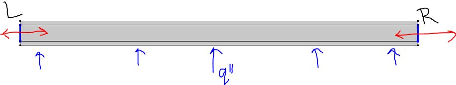

I have been trying to simulate reciprocating flow of a convective fluid through a heated channel in COMSOL-Multiphysics. Basically, if there are two boundaries to the channel Left L and right R, the boundary L should act as an inlet for half of the oscillation time-period. During this half, the boundary R should act as an outlet. Similarly, in the next half of the cycle, R should act as the inlet, while L now is the outlet. Obviously, it is a time dependent simulation.
I do understand that I need to define an inlet mass flux or velocity profile at the boundaries. The problem is that I cannot figure out how to change the type of boundary conditions at the cycle halves.

Dear Indrasis, You can drive the flow entirely from one of the boundaries by for example specifying a time periodic mass flow condition. At the other boundary, you simply put a static pressure condition and uncheck the suppress backflow option (and possibly check the normal flow option).

Appreciate the reply. The method you are suggesting will change the type of oscillatory flow,i.e., it will become a pulsating flow. A pulsating flow is unidirectional with mass flow rate being modulated as a sinusoid at one end. However, I want to simulate a reciprocating flow where the flow inlets and exits are cyclic (bi-directional flow). This too falls as a sub-category of oscillating flow. I am especially interested in the resulting temperature gradients. This is why, I wanted to switch the boundary conditions.
I have found a method by the way. Let us assume that the left end is L and the right end is R. If I define a sinusoidal pressure profile at L and a sinusoidal pressure profile at R (but phase shifted by pi radians at the R end), with the suppress backflow option unchecked, I have found that the reciprocation can be achieved. In this way, for a half cycle, the pressure gradient driving the flow is from L to R, while in the next half-cycle it switches from R to L. This could be possible because the COMSOL documentation suggests that with a pressure type boundary condition, the boundaries can act both as an inlet and outlet (depending on the local pressure). When I combine this flow set-up with an open boundary type boundary condition at L and R (in the heat transfer section) with a specified upstream temperature, the heat transfer aspect can also be aptly modeled. Once again becasue the open boundary type boundary condition, can act as both an inlet with upstream temperature if the flow is into the domain and as a zero conductive flux outlet, if the flow is out of the domain. The direction of the flow is obviously being determined when the flow equations are being solved for the particular time-step.
However, my primary objective is to assign a sinusoidal mass flow rate profile at the domain ends. This fails because both the mass and velocity inlet boundary conditions require the flow to be only into the domain or out of the domain. Therefore, I am in need of switching them each half-cycle.

OK Mats, reading your comment with some more focus, I can understand it a little more. Do you mean to say that the mass flux profile will have negative parts also and when imposed at one of the boundaries it will act as both inlet and outlet. In this way with a zero gauge pressure at the other end, during the second half cycle the other end will actually work as the inlet. Right ?
And for temperature I can just use the open boundary option on both the boundaries with the upstream temperature set to whatever I need. This temperature will be automatically applied to the boundary which acts as the inlet during a particular half cycle.

Yes, that's right. Let me know if you run into any other issues.

Hi Mats, Thanks a lot. The setup suggested by you works perfectly.
