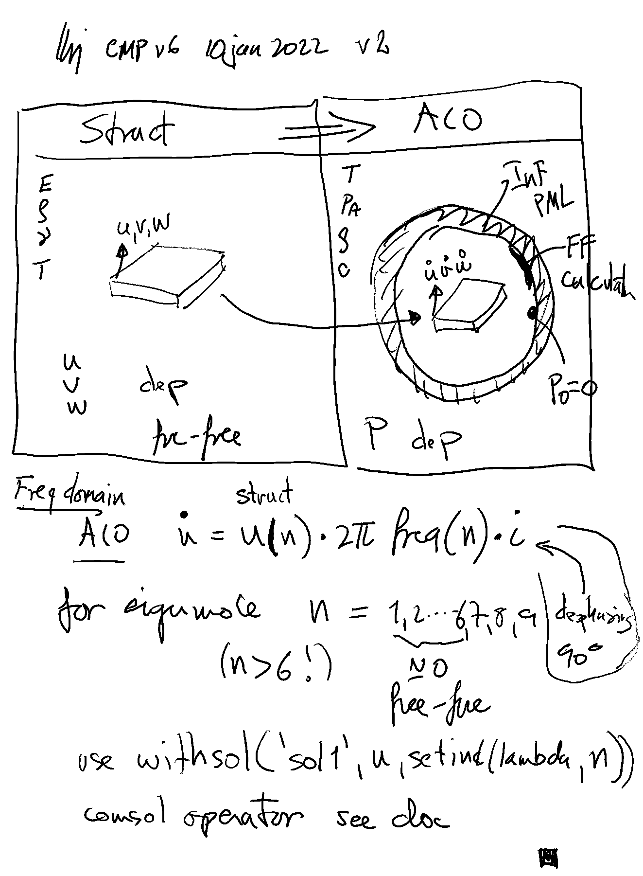

Hi again,
You are welcome, the real fun of physics comes with COMSOL Multiphysics, you may really learn how things are linked and how they behave, but be aware one need to connect to reality by comparing the results to measurements (or articles with measurements) to ensure calibration, and the full VV&C (Validation, Verification and Calibration of any model.
What I often do is to sketch up the links, as in the page below from my Remarkable(r) notebook :)
If you want to go a step further, and see the eigenmode changes due to the presence of air (or water if that is your surrounding medium) you should study Nagi's excellent blog, for a first order correction, using Structure without fluid or ACO, see:
https://www.comsol.com/blogs/natural-frequencies-immersed-beams/
Have fun COMSOLing Sincerely Ivar
PS with updated _v2.PNG containing the "i" ...
Have fun COMSOLing,
Sincerely,
Hi again, You are welcome, the real fun of physics comes with COMSOL Multiphysics, you may really learn how things are linked and how they behave, but be aware one need to connect to reality by comparing the results to measurements (or articles with measurements) to ensure calibration, and the full VV&C (Validation, Verification and Calibration of any model. What I often do is to sketch up the links, as in the page below from my Remarkable(r) notebook :) If you want to go a step further, and see the eigenmode changes due to the presence of air (or water if that is your surrounding medium) you should study Nagi's excellent blog, for a first order correction, using Structure without fluid or ACO, see: https://www.comsol.com/blogs/natural-frequencies-immersed-beams/ Have fun COMSOLing Sincerely Ivar PS with updated *_v2.PNG containing the "*i" ...

Hello again,
I noticed I have a slight error in my notes, the displacement, velocity respectively acceleration are dephased by 90°, each, so the correct formula for a boundary displacement is d(x,y,z)[m], the velocity is v(x,y,z)=d(x,y,z) * (2 * pi * i * freq) and the acceleration is respectively a(x,y,z)=d(x,y,z) * (2 * pi * i * freq)^2. As COMSOL is working in true complex notation. You will notice that if you use the ACO boundary "normal displacement", or velocity, respectively acceleration you will find these equations in the "equation view" showing the internal COMSOL equations. the complex "* i" includes then the dephasing, but normally for your case the amplitude shape should not change.
Sincerely Ivar

Hello again, I noticed I have a slight error in my notes, the displacement, velocity respectively acceleration are dephased by 90°, each, so the correct formula for a boundary displacement is d(x,y,z)[m], the velocity is v(x,y,z)=d(x,y,z) * (2 * pi * i * freq) and the acceleration is respectively a(x,y,z)=d(x,y,z) * (2 * pi * i * freq)^2. As COMSOL is working in true complex notation. You will notice that if you use the ACO boundary "normal displacement", or velocity, respectively acceleration you will find these equations in the "equation view" showing the internal COMSOL equations. the complex "* i" includes then the dephasing, but normally for your case the amplitude shape should not change. I have updated the PNG above to ..._v2.PNG Sincerely Ivar
