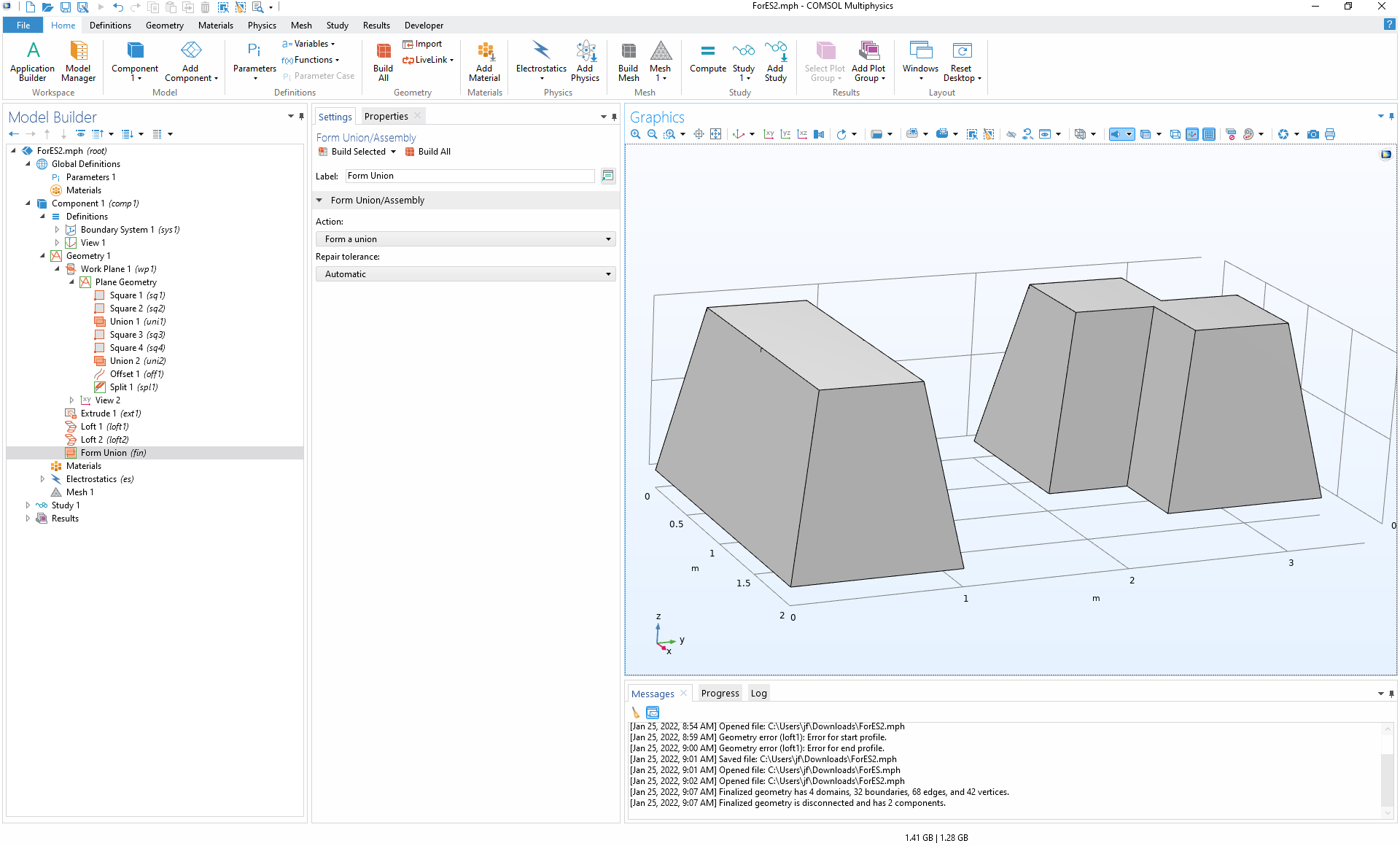

I am hardly an expert in this aspect of our software, and I get the strong feeling that there is a more elegant solution than what follows, but in the interest of giving you at least one quick solution, here's a way to get it done (see the attached file):
Draw your squares/rectangles in a workplane Use an offset operation to obtain a shrunk version of each square/rectangle inside of each square/rectangle Extrude the shrunk squares/rectangles Use a loft operation to connect the two end surfaces of the desired trapezoidal prisms
Jeff Hiller
Hello Eric, I am hardly an expert in this aspect of our software, and I get the strong feeling that there is a more elegant solution than what follows, but in the interest of giving you at least one quick solution, here's a way to get it done (see the attached file): Draw your squares/rectangles in a workplane Use an offset operation to obtain a shrunk version of each square/rectangle inside of each square/rectangle Extrude the shrunk squares/rectangles Use a loft operation to connect the two end surfaces of the desired trapezoidal prisms Best, Jeff

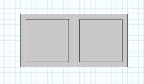

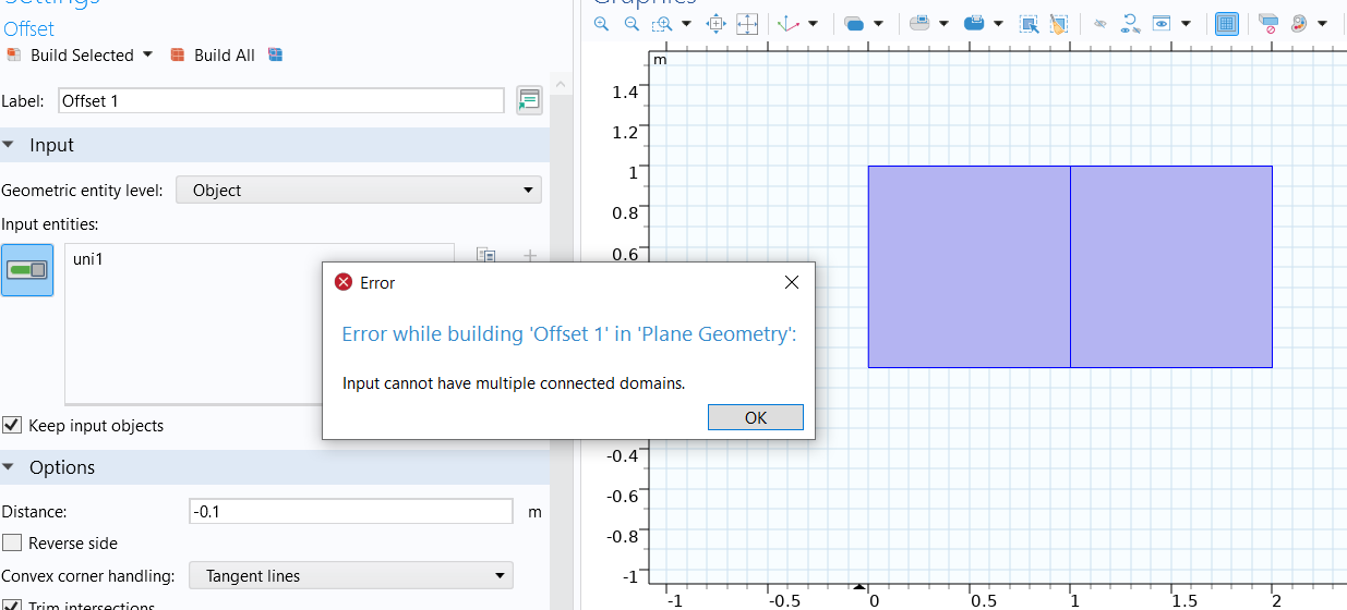

We cannot open hour file without the design module but we had a try offsetting the shapes in the meantime.
Offsetting cannot have multiple connected domains (see 1st picture) When selecting all shapes in work plane, then we have disconnected shrunk shapes (see 2nd picture).
Then if we'd extrude and loft, we would get an "internal" slope between the 2 squares, wouldn't we?
Many thanks for yout swift reply Jeff. We'll request an extention of the Design module demo to try this out. edit -- We cannot open hour file without the design module but we had a try offsetting the shapes in the meantime. Offsetting cannot have multiple connected domains (see 1st picture) When selecting all shapes in work plane, then we have disconnected shrunk shapes (see 2nd picture). Then if we'd extrude and loft, we would get an "internal" slope between the 2 squares, wouldn't we?
Posted: 4 years ago 25.01.2022, 15:17 MEZ
Updated: 4 years ago 26.01.2022, 15:53 MEZ
Hello Eric,

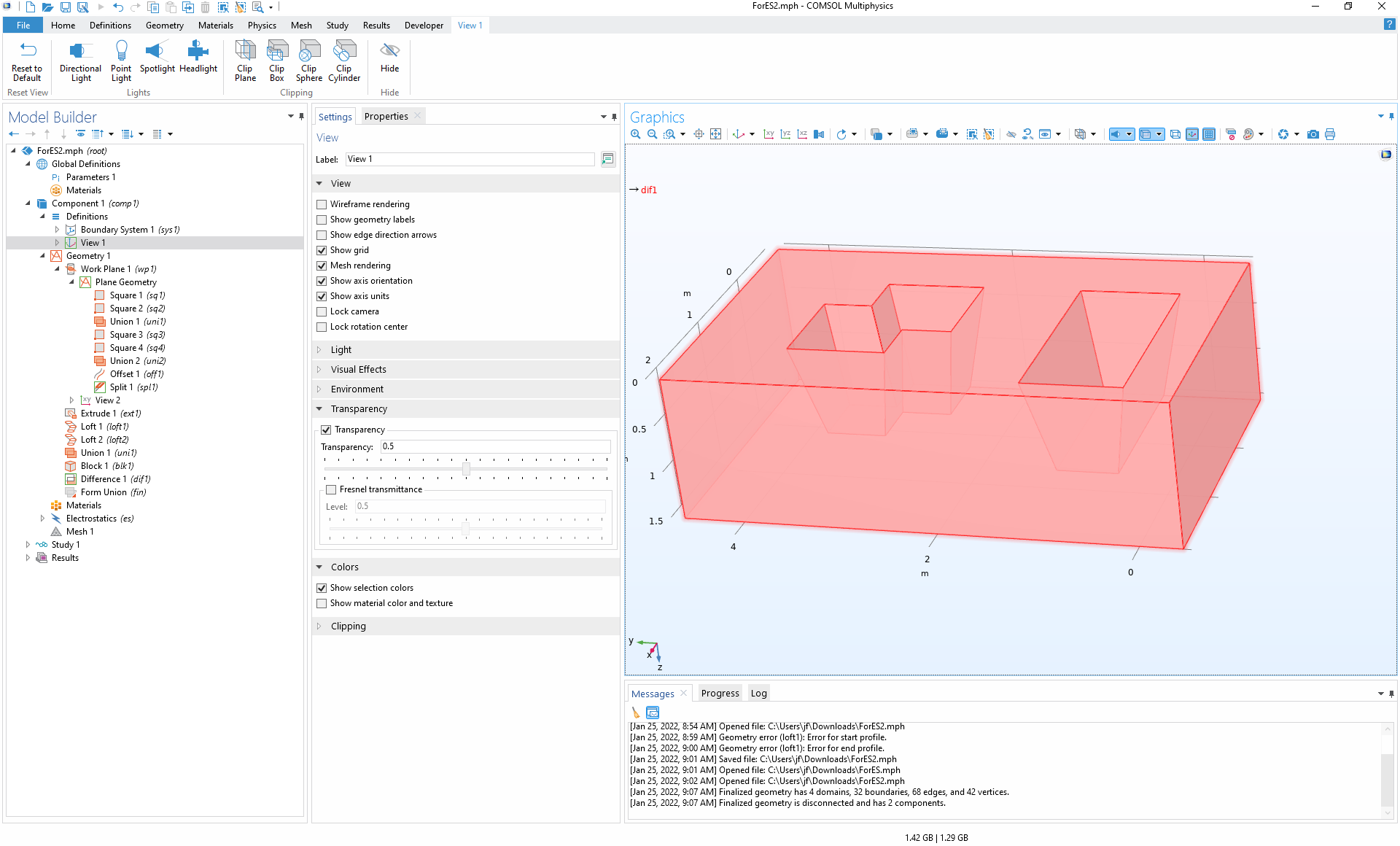

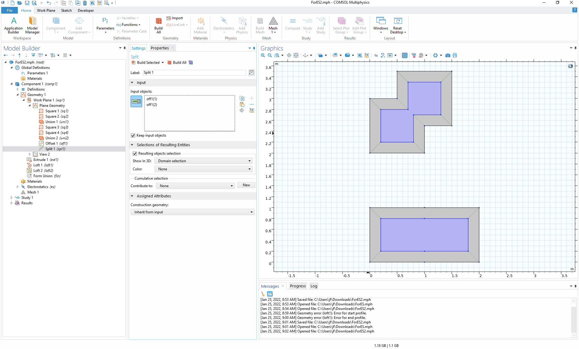

In that case (overlapping or contiguous squares/rectangles), you can take the union of the two squares/rectangles with the "keep interior boundaries" checkbox turned off (this will remove undesired internal edges) before taking the offset.
See attached screenshots and mph file (for when you can open it). One of the screenshots shows a Split operation that I did not mention yesterday.
Jeff Hiller
Hello Eric, In that case (overlapping or contiguous squares/rectangles), you can take the union of the two squares/rectangles with the "keep interior boundaries" checkbox turned off (this will remove undesired internal edges) before taking the offset. See attached screenshots and mph file (for when you can open it). One of the screenshots shows a Split operation that I did not mention yesterday. Best, Jeff

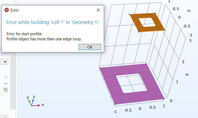

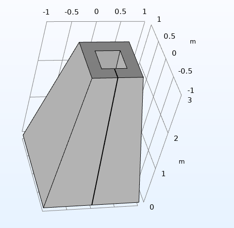

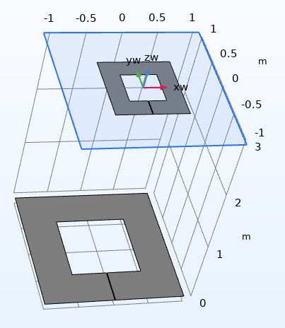

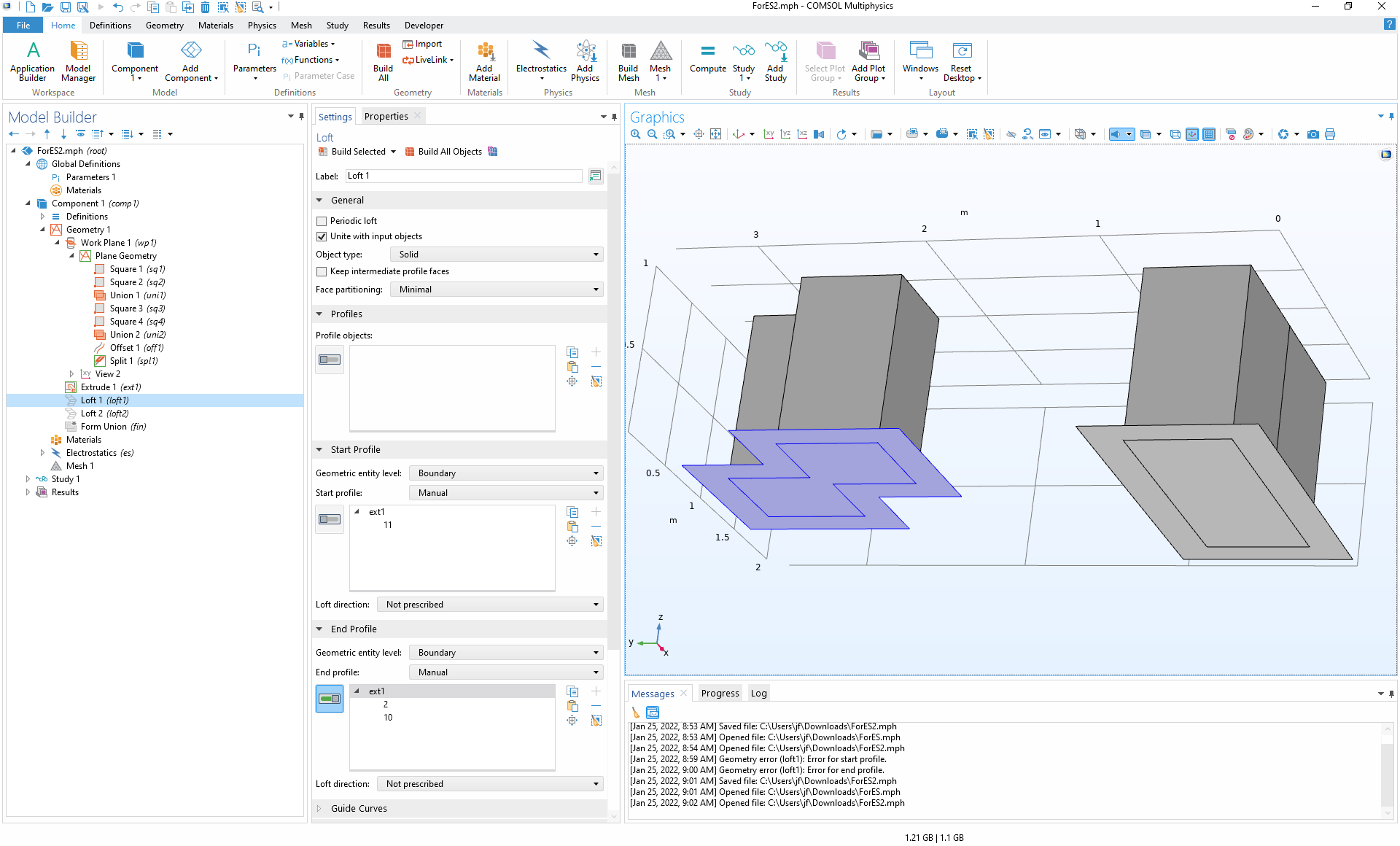

I guess the inital exemples I gave were a bit too simple. Eventually, our final geometry to be extruded is composed of rectangles than can form shapes such as a rectangle hollowed out by another rectangle.
The steps you suggested are working great if you have a single edge loop but breaks down when we have more than 1, at the level of the loft feature.
I guess we could make many single edge loop shapes, perform the operation and then try to merge vertices at interfaces but we are steering away from a simple and elegant solution.
Any suggestions, anyone working with structures having non vertical sidewalls?
Pictures in copy: 00 and 01 are showing a case where the steps work because we have only one edge loop. 02 is showing the more complex actual use case we'd like to handle and the associated error.
BR, Eric
Hi Jeff and sorry for the late reply, We got hold of another design module demo now. I guess the inital exemples I gave were a bit too simple. Eventually, our final geometry to be extruded is composed of rectangles than can form shapes such as a rectangle hollowed out by another rectangle. The steps you suggested are working great if you have a single edge loop but breaks down when we have more than 1, at the level of the loft feature. I guess we could make many single edge loop shapes, perform the operation and then try to merge vertices at interfaces but we are steering away from a simple and elegant solution. Any suggestions, anyone working with structures having non vertical sidewalls? Pictures in copy: 00 and 01 are showing a case where the steps work because we have only one edge loop. 02 is showing the more complex actual use case we'd like to handle and the associated error. BR, Eric

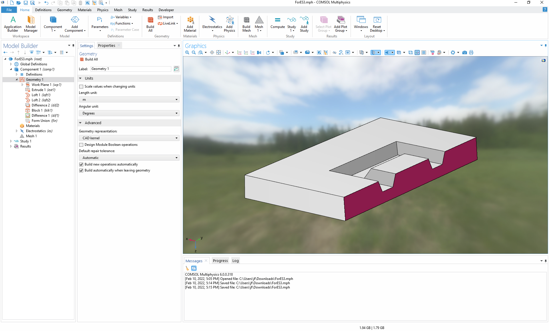

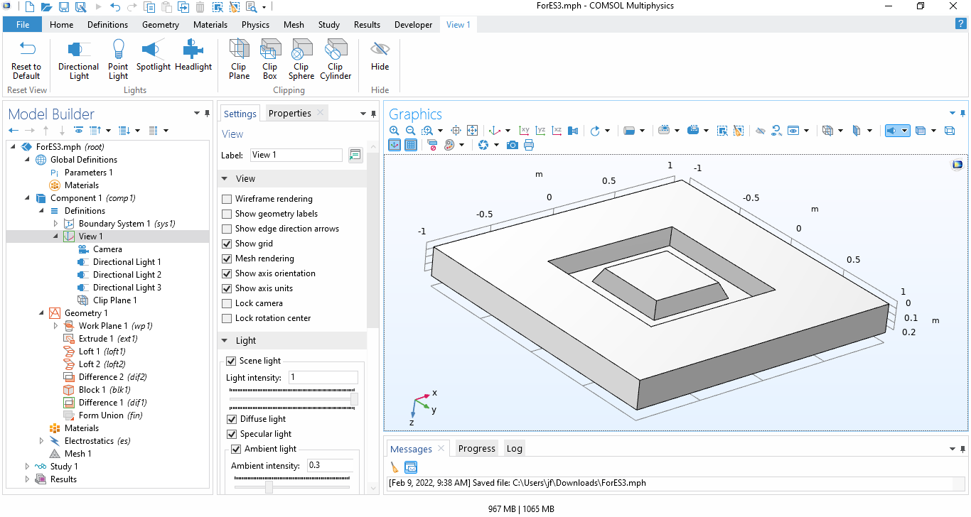

Hi Eric,
Lofting does work one loop at a time, so for the case you describe in your latest message you can use two loft operations, one for the inner loop and one for the outer loop, as shown in the attached files.
Jeff Hiller
Hi Eric, Lofting does work one loop at a time, so for the case you describe in your latest message you can use two loft operations, one for the inner loop and one for the outer loop, as shown in the attached files. Best, Jeff
Posted: 3 years ago 15.02.2022, 13:16 MEZ
Thank you Jeff. We will evaluate this technique and see if it is simpler than our current implementation.
