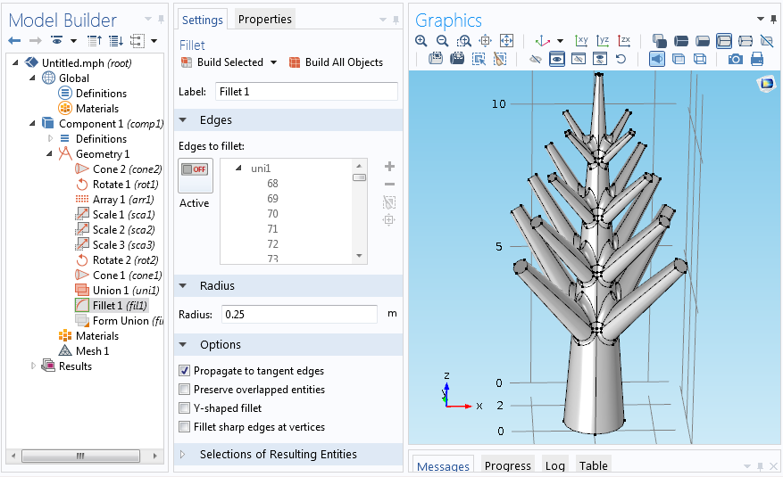

Creating trees is an interesting geometric question. With the new Design Module (www.comsol.com/design-module) you do have fillets available in 3D. The attached screenshot will give you some ideas about how you might create such a structure.
