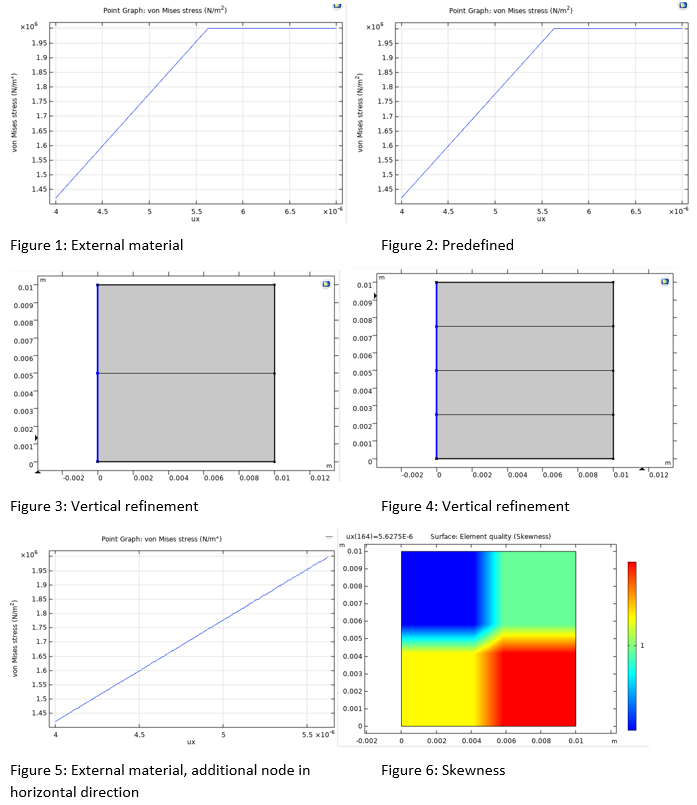

Hi everyone, I’m facing some issues regarding the implementation of an external material routine in COMSOL. The aim is to provide a general stress-deformation routine for an elastic-ideal plastic material behavior. To validate the implementation in a first step, I reduced the hyperelastic material description to the well-known and already implemented Neo-Hookean material model. The model represents a square. On the left edge the horizontal and on the lower edge the vertical displacement is fixed, respectively. On the right edge a horizontal displacement is applied to simulate a tensile test. In a first step the model is discretized using just one single element with linear ansatz functions for discretization. In this case, the external material routine and the implemented version in COMSOL lead to identical results, as shown in the Figure. Left is the external material model and, on the right, the predefined Neo-Hookean with elastic-ideal plastic behavior, Figures 1 and 2. Furthermore, the convergence for the external material is fine. The same holds for the case, that the mesh is refined in vertical direction, Figures 3 and 4. However, as soon as there is an additional node in horizontal direction, whether from using higher-order elements or more elements with linear ansatz functions in horizontal direction, the model does no longer converge in the plastic domain. Even in the elastic domain the stress-strain-curve looks like some noise has been added, Figure 5. Since, the routine works properly for one element I’m not sure where to locate the issue. One aspect that caught my intention is the skewness of the elements. When using multiple elements in horizontal direction it slightly starts to change, Figure 6. This is not the case for the other simulations. But this is just a random thought. Has anyone ever tried to implement such routine in COMSOL and has experienced the same issue? Many thanks in advance.

Hi Natalie,
I am not an expert in nonlinear mechanics. However what catches my attention is that your material curve seems to have a sharp kink where the transition linear-plastic is. If this is the case the derivative isn't continuous. I found that kinks in material curves can be an issue in nonlinear electromagnetics. You might consider to add a smooth transition.
Just a wild guess. No idea why this would be an issue with 2 elements and not with one.
Cheers Edgar

Hi Natalie, I am not an expert in nonlinear mechanics. However what catches my attention is that your material curve seems to have a sharp kink where the transition linear-plastic is. If this is the case the derivative isn't continuous. I found that kinks in material curves can be an issue in nonlinear electromagnetics. You might consider to add a smooth transition. Just a wild guess. No idea why this would be an issue with 2 elements and not with one. Cheers Edgar

An ideally plastic material has the same stress independent of strain once you have reached the yield point. Thus, if you have two adjacent elements in uniaxial tension, the solution that the strain is 1% in the first element and 2% in the second element is just as correct as the solution where the strain in both elements is 1.5%. It is in general not possible to test such a material model in any other configuration than one where the strains are completely controlled by the boundary conditions.
