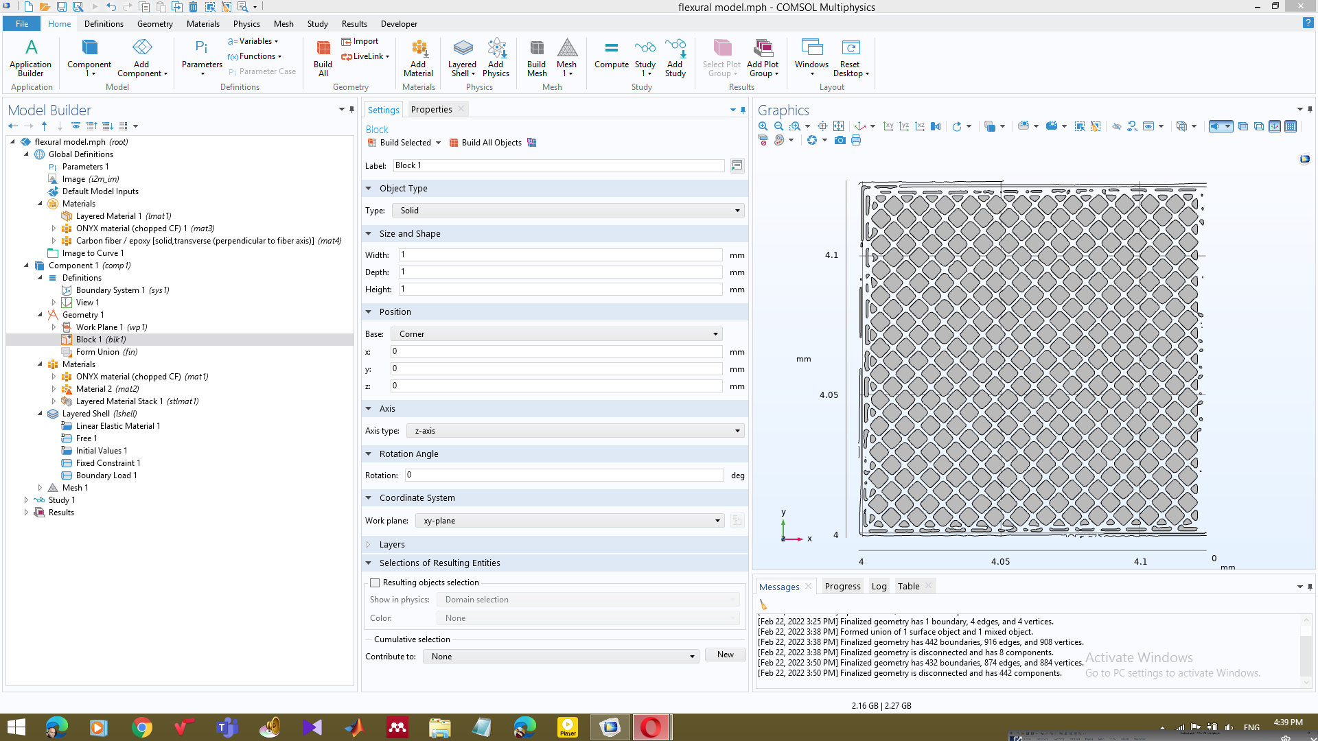

Hello everyone, I'm working on simulating a composite structure using layered shell interface. since the structure should have different infill patterns for two types of different layers, There needs to be two different layers with two different geometries. what I'm stuck with is how to stack two different type of layer geometries on top of one another, should I define another component ? or should I use two work planes for one component?
