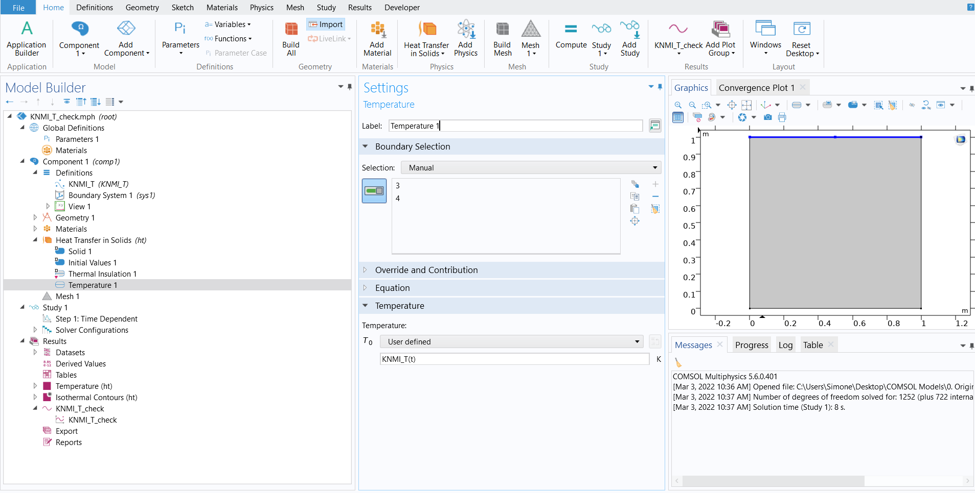

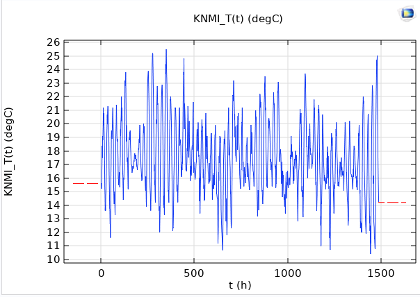

In my simplified 2d-square model I defined the upper boundary to have a temperature boundary condition of a measured temperature signal (over time) of the Royal Netherlands Meteorological Institute (KNMI) so I expext that after running the temperature signal (over time) of the upper boundary is exactly the same as the T_KNMI plot.

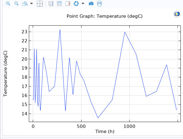

Unfortunately this is not the case.
Can someone please help me out? (see attached model)
Kind regards, Simone

Comsol doesn't know how and when your data are changing. Look at your settings for time-stepping. Use intermediate or strict and specify a time step that corresponds to your KNMI data.

Are you specifying the time steps taken by the solver, rather than relying on automatic time-stepping? If not, you should, to ensure that they are small enough to capture the variations in your inputs.

Thank you very much, It worked!
