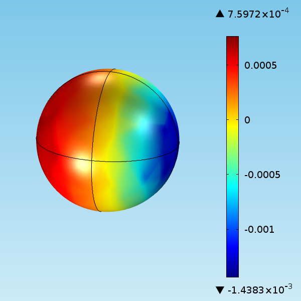

I tried the simplified model as you suggested, with a copper sphere inside of a box of air. I set the boundaries of the box to ground, except for one side which I gave a potential. I set the boundaries of the sphere to floating potential, as in my other model. I used electrostatics to solve only the domain of air, not the domain inside of the conductor.
When I tried to do a surface plot on the sphere of surface charge density, I recreated the same error from my other model. I attached this simplified model to this post. It's a bit strange, but I'm guessing there's a fundamental error in my geometry or boundaries and materials set-up that is causing the error in both models.
Thanks so much for your responses! I tried the simplified model as you suggested, with a copper sphere inside of a box of air. I set the boundaries of the box to ground, except for one side which I gave a potential. I set the boundaries of the sphere to floating potential, as in my other model. I used electrostatics to solve only the domain of air, not the domain inside of the conductor. When I tried to do a surface plot on the sphere of surface charge density, I recreated the same error from my other model. I attached this simplified model to this post. It's a bit strange, but I'm guessing there's a fundamental error in my geometry or boundaries and materials set-up that is causing the error in both models.
Posted: 1 decade ago 31.07.2012, 09:49 MESZ
I ran your model, as is, and got the result you can see in the attached figure. I guess this what you (and I both) were expecting.
However, I'm using the latest Comsol version, 4.3, whereas you seem to be on 4.2a. Luckily, I still have the old version installed, and when I ran the model there, I could reproduce the error you described ("Failed to evaluate variable. [...] mod1.es.nD"). I would think this is (or was) a bug.
As to if and why there's a bug, you can only get a definitive answer from Comsol's developers, via Support. But if I was to venture a guess, it would be that, in the old version, the surface charge density was not defined properly on (some or all) interior boundaries.
I suspect that because, when you switch on "Equation View" (from the "Show" drop-drown menu in the Model Builder tab), you can see that the surface charge density is defined whenever you add a boundary condition such as "Ground" or "Electric Potential", but not for the "Floating Potential". This is different in 4.3.
The Equation View is also your way in to working around the bug in 4.2a. Just define a new variable (say, nD) on all boundaries, and copy the expression from the Equation View: es.unx*(down(es.Dx)-up(es.Dx))+es.uny*(down(es.Dy)-up(es.Dy))+es.unz*(down(es.Dz)-up(es.Dz)). By the way, this is just the defintion of the surface charge density, n·(D₁-D₂), at an interface between media 1 and 2 with normal vector n, expressed in terms of Comsol's internal variables. You can also plot the above expression directly.
I ran your model, as is, and got the result you can see in the attached figure. I guess this what you (and I both) were expecting. However, I'm using the latest Comsol version, 4.3, whereas you seem to be on 4.2a. Luckily, I still have the old version installed, and when I ran the model there, I could reproduce the error you described ("Failed to evaluate variable. [...] mod1.es.nD"). I would think this is (or was) a bug. As to if and why there's a bug, you can only get a definitive answer from Comsol's developers, via Support. But if I was to venture a guess, it would be that, in the old version, the surface charge density was not defined properly on (some or all) interior boundaries. I suspect that because, when you switch on "Equation View" (from the "Show" drop-drown menu in the Model Builder tab), you can see that the surface charge density is defined whenever you add a boundary condition such as "Ground" or "Electric Potential", but not for the "Floating Potential". This is different in 4.3. The Equation View is also your way in to working around the bug in 4.2a. Just define a new variable (say, nD) on all boundaries, and copy the expression from the Equation View: es.unx*(down(es.Dx)-up(es.Dx))+es.uny*(down(es.Dy)-up(es.Dy))+es.unz*(down(es.Dz)-up(es.Dz)). By the way, this is just the defintion of the surface charge density, n·(D₁-D₂), at an interface between media 1 and 2 with normal vector n, expressed in terms of Comsol's internal variables. You can also plot the above expression directly.
