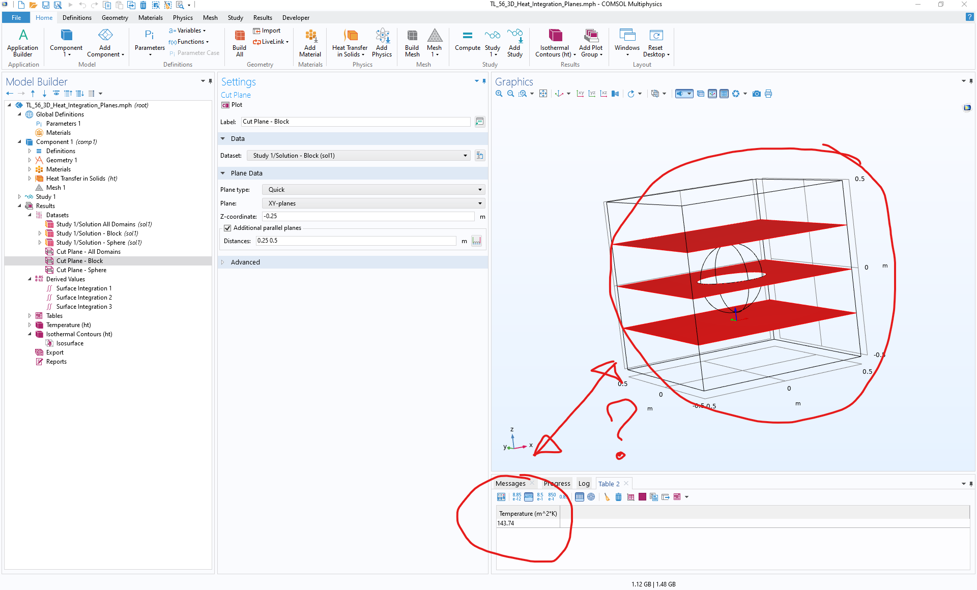

I was wondering if there was a way to obtain the integrals of a series of cut planes (created though the "Additional parallel planes" option"). My problem is illustrated in the attached screenshot where you can see a series of 3 cut planes, but COMSOL only outputs a single value when asked to integrate over these cut planes. I could always define independant cut planes, but then 1) the results would not be stored in a single table and 2) it would become extremely tedious if I needed to repeat the process like 20 times or more.

Petr,
one option is to use boolean expressions in the integrand, that only evaluate to true on the specific plane you want to integrate.
