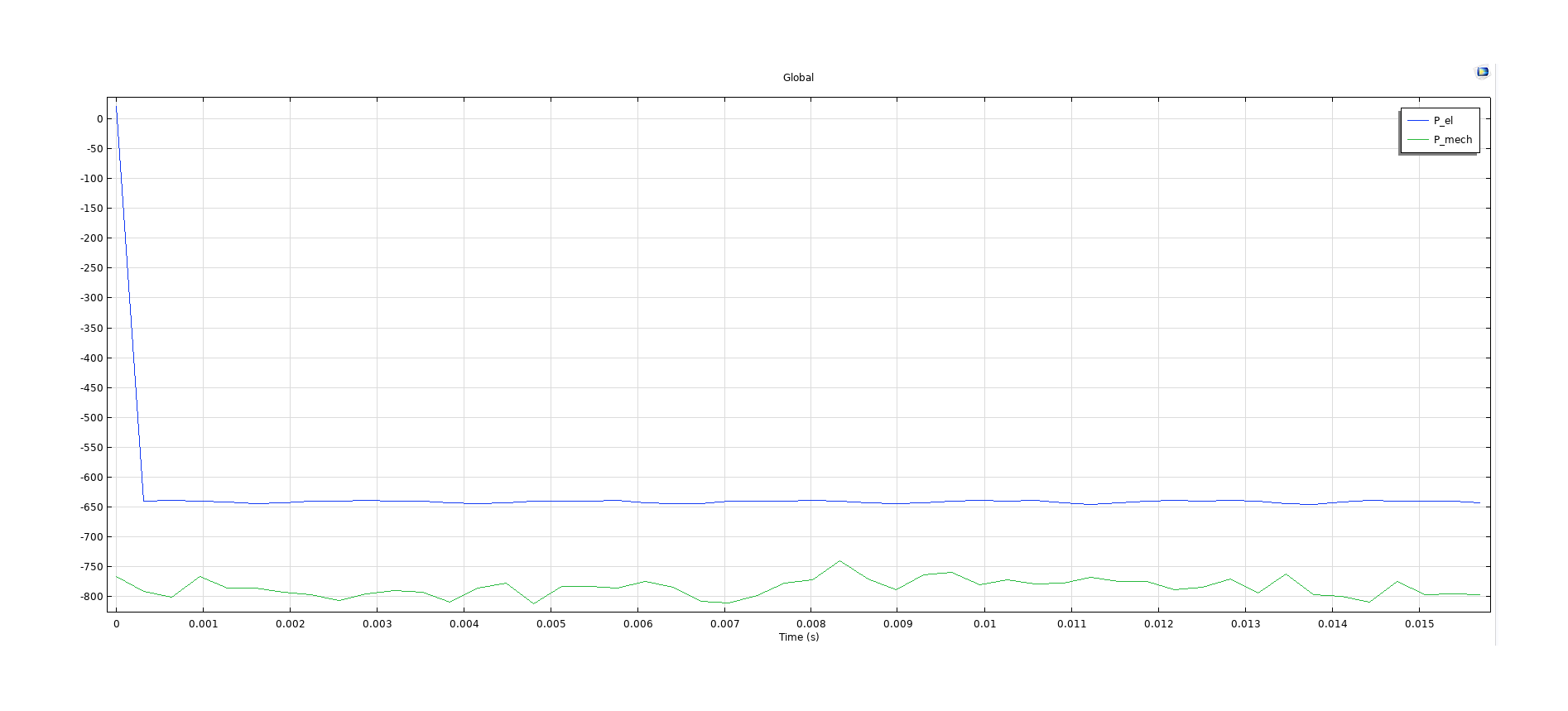

I could not upload the model with solutions due to 5MB size restriction, so I try to explain the results via screenshots. You can find a plot of P_el vs P_mech attached. There is a delta around 140W. My computed electrical losses sum up to around 33W. Big difference.

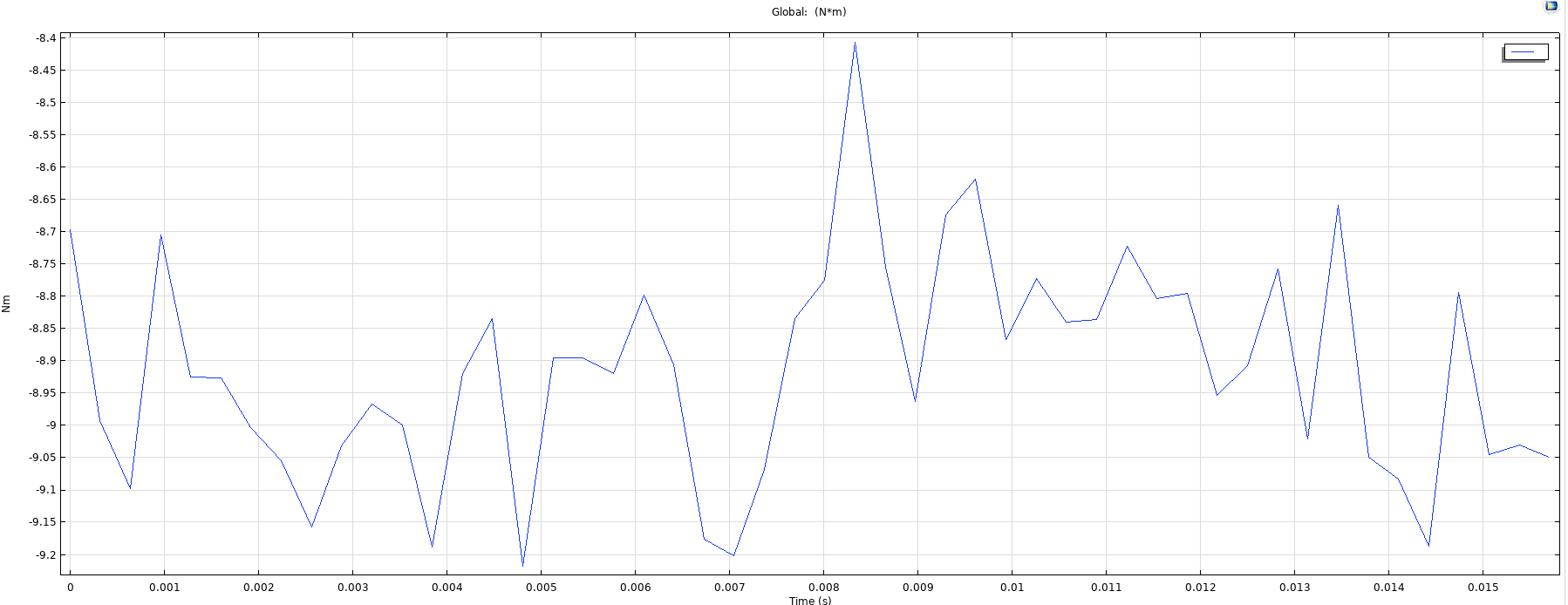

I have been trying to narrow down the issue. I figure that it must be an issue with the force calculation that I am using to compute the rotor torque. The computed results of the rotor torque seem to be pretty unstable. And for the topology of the machine, the large ripple torque that I am seeing doesnt pass a sanity test. I also attached a plot of the rotor torque results.

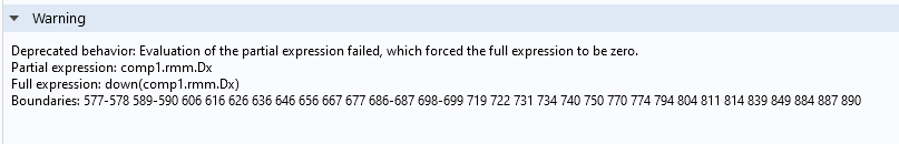

I have read some blogs/tutorials online and understand the sensitiivity/limitations of the maxwell stress tensor to non-linear reigons, so ive tried to ensure I am computing the torque only on air reigon around the rotor. I can see that I am getting a warning message when computing the torque. So far, I have tried to research this "deprecated behavior" message on the forum, but havent found anything yet. Maybe this is a hint :)
Ive done some kind of mesh refinement study around the domains which I am computing the torque. I refined the mesh in the reigons surrounding the rotor, it doesnt seem to improve the stability of the force calculation. For me this was suprising, I was sure that this would be the issue.
