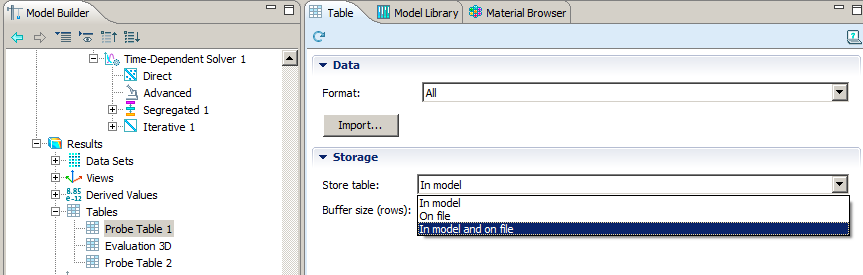

Dear Tolga
I trying to do what you have written here. I created a new table under table node. But I do not understand what do you mean by, " set the storage to 'In model and on file'. Make sure you set the file name to be saved." Rest I am able to find. Please tell me.
Thanks
Deepak

Deepak,
After you have created the table, activate it on the model builder. You can set the storage using the Table options window. Change 'Store table' to 'In model and on file'. Screenshot attached.
Hope it helps.
Tolga
