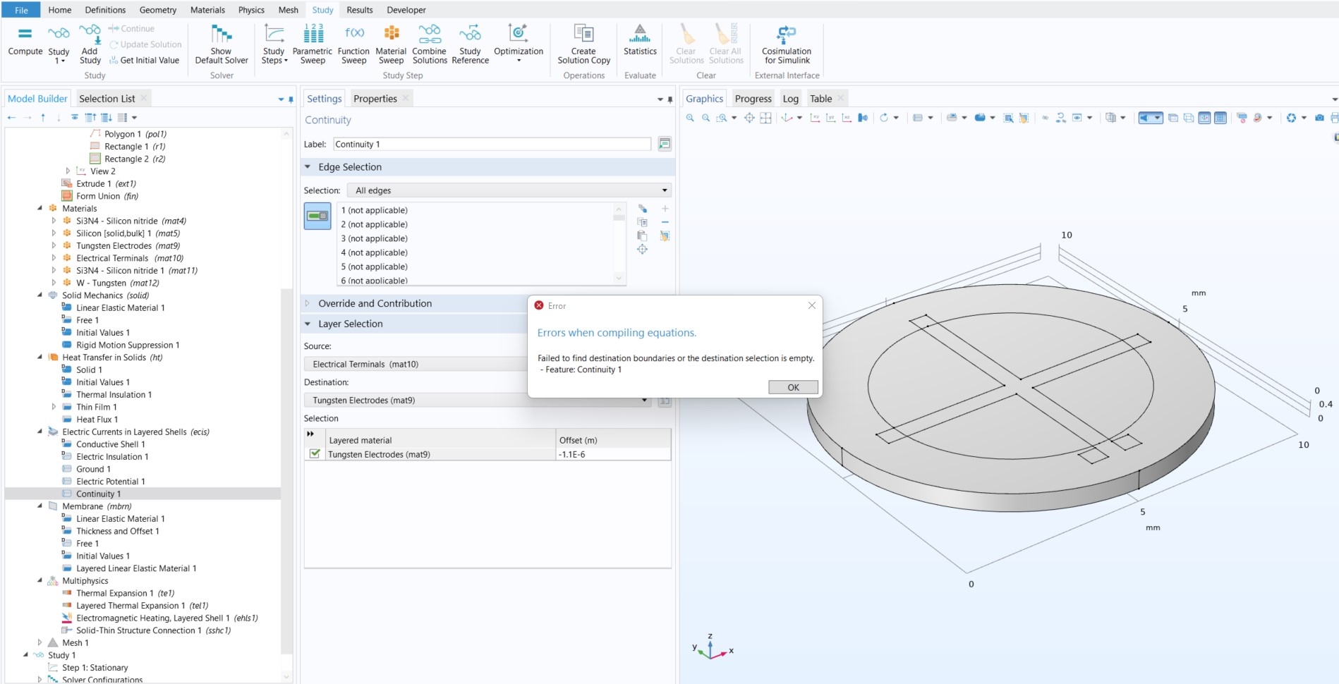

I am trying to study the behaviour of Joule heating on a silicon nitride membrane through tungsten electrodes. After setting up the source and destination of the Continuity, it is showing the error saying that 'failed to find destination' which i have already defined (Tungsten Electrode in cross form).
What can be the cause of this error, Please help. Refer attached image

Hello Kapil,
Would you be able to post the .mph file (with the mesh and solution cleared out to reduce the file size if necessary)?
