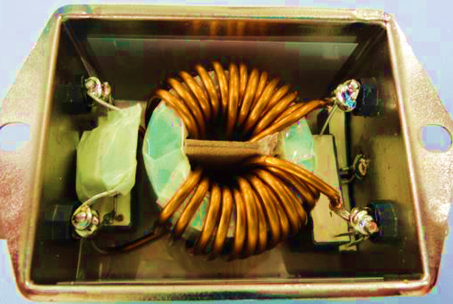

I'm interested in simulating EMC filters as the one in the attachment. It includes a common mode choke and capacitors, mounted in a metallic case and it works between 10 kHz and 100 MHz.
Is it possible to extract filter attenuation in standard impedance conditions (input and output impedance = 50 Ohm) with COMSOL AC/DC Module?

I have some experience in SPICE simulation but, even thou the approach is way more easy than FEM simulation, quality of results is poor since you can't take into account mutual interactions between components. I'm quite sure 3D simulation can fill that gap but my concern is about the time spent in building a model with many components (capacitors, chokes and conductors), as well as time spent for meshing and simulating.
The video you posted is interesting. It seems more complex systems than a simple inductor are hard to be simulated. I was expecting a part of the tutorial was about setting sources (a test voltage for instance). Isn't there a part 2 or any other video about it?

Well, a I said, the product I want to simulate consists of a metallic housing with a CM choke and some capacitors in it, connected by means of floating conductors. So, is there a limited number of elements for a mesh with COMSOL?
Can I ask you which 3D tool are you referring to?
As I said, mine is a feasibility study of filter 3D simulation by means of any suitable software.

There is no limit in meshing parts in comsol, but you need to resolve enough detail to get accurate answers. If you are serious about doing this 3D model then I would start with modeling the capacitors. Its a lot less complicated then a CM choke.
