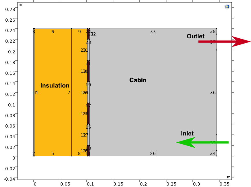

I am writing to get some supporto on my model. My intent is to simulate a setup where an ambient (named cabin in the attached scheme) presents a costant and fixed temperature and relative humidity and it's exposed on the left (after the insulation ambient) to an external T. To get the constant conditions on the cabin sides, I have added and Inlet and Outlet interface to the flow physics, as well as inflow and outflow for the heat transfer and moisture transport physics. I am using a Laminar flow model because I do expect low reynolds and I am using an initial stationary solver for the flow, followed by a time dependent solver. However the first solver presents the following error:
