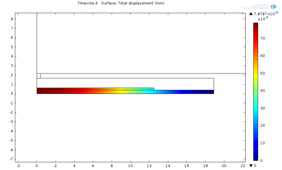

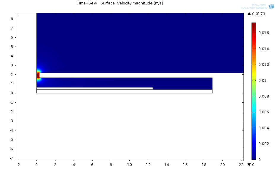

I was wondering if someone could help me figure out how to model the fluid structure interaction using the piezoelectric device physics model as well. I am trying to model synthetic jet actuators and I am having a hard time coupling the physics together to make the model work. I am new to the fluid structure interaction model so that is probably where my issues are. I am able to get the piezo element to deflect but im not sure how to tie it to the brass element so that deflects and then that deflection causes the fluid in the cavity to displace. If anyone could help me that would be great.

I think you fall into a trap that you have to use Piezoeletric Devices and Fluid-Structure Interaction.
As you know, there is no Piezoelectric Material Domain Settings in Fluid-Structure Interaction. This is the first problem you had. So, to consider both Linear Elastic Material and Piezoelectric Material Domain, you need to change all applications. These are,
1. Piezoelectric Devices to consider both Cu and PZT-5H
2. Laminar Flow to consider Air
3. Moving Mesh to consider both air and solid
4. Boundary ODEs and DAEs to consider solid velocity
5. Time Dependent Solver
And, physics couplings are,
1. air acts on the surface of solid : use the boundary load
r-term : spf.T_stressr*dvol_spatial/dvol
z-term : spf.T_stressz*dvol_spatial/dvol
2. in fluid, wall : moving wall : solid velocity from ODEs settings on the interface of the air/solid
3. define the solid velocity in ODEs. if solid displacement is u and w, solid velocity is ut and wt where t means time.
4. In moving mesh, use 1. prescribed deformation to consider solid displacement, 2. prescribed mesh displacement to consider solid displacement & axial symmetry.
thanks.
