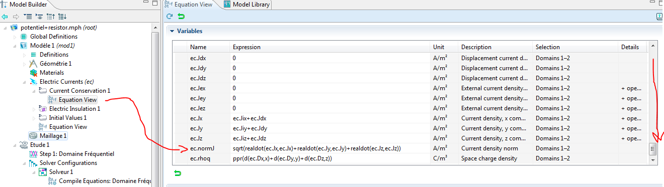

Thanks for the prompt reply. I just wondered what reacf or ec.normJ are. One cannot use anything which she/he does not understand. I agree that numerical calculation of gradients is a challenge, but it is most crucial in electrochemistry. With meshing I can change the value of electric current 0-100%. Which one is correct?
Hence: what is the ec.normJ?
turn on the equation view (Options preferences) and look at the definition of the COMSOL internal variables, in this cas it is the norm (sqrt(Jx^2+Jy^2+Jz^2)) of the current density, the formula is "complex compliant" by the "realdot()" operator that is just there to correctly get the scalar value for complex current densities (typically AC cases)

I find it nicely in my 4.3 ;)
