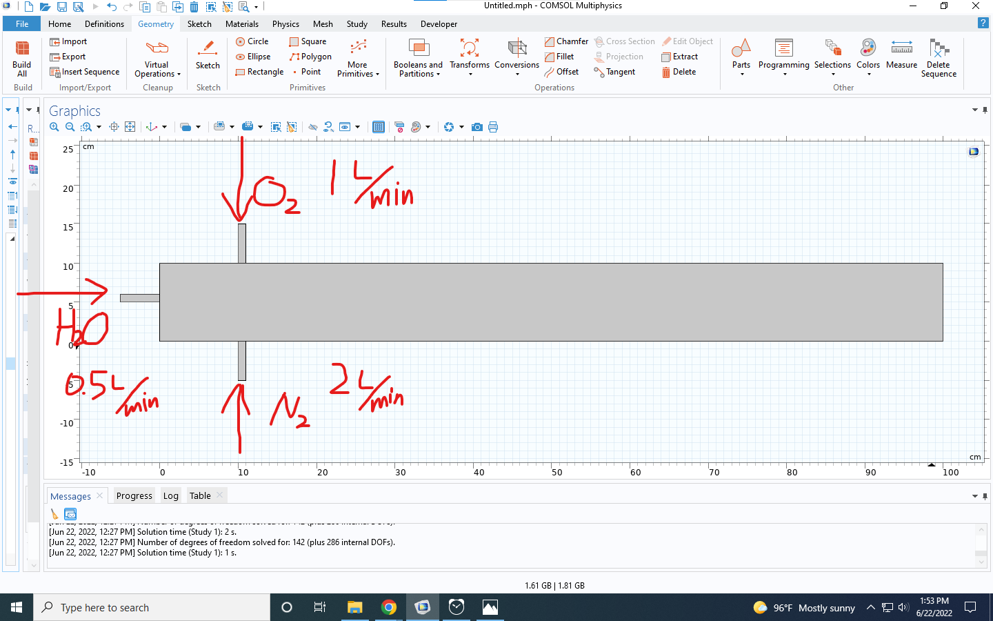

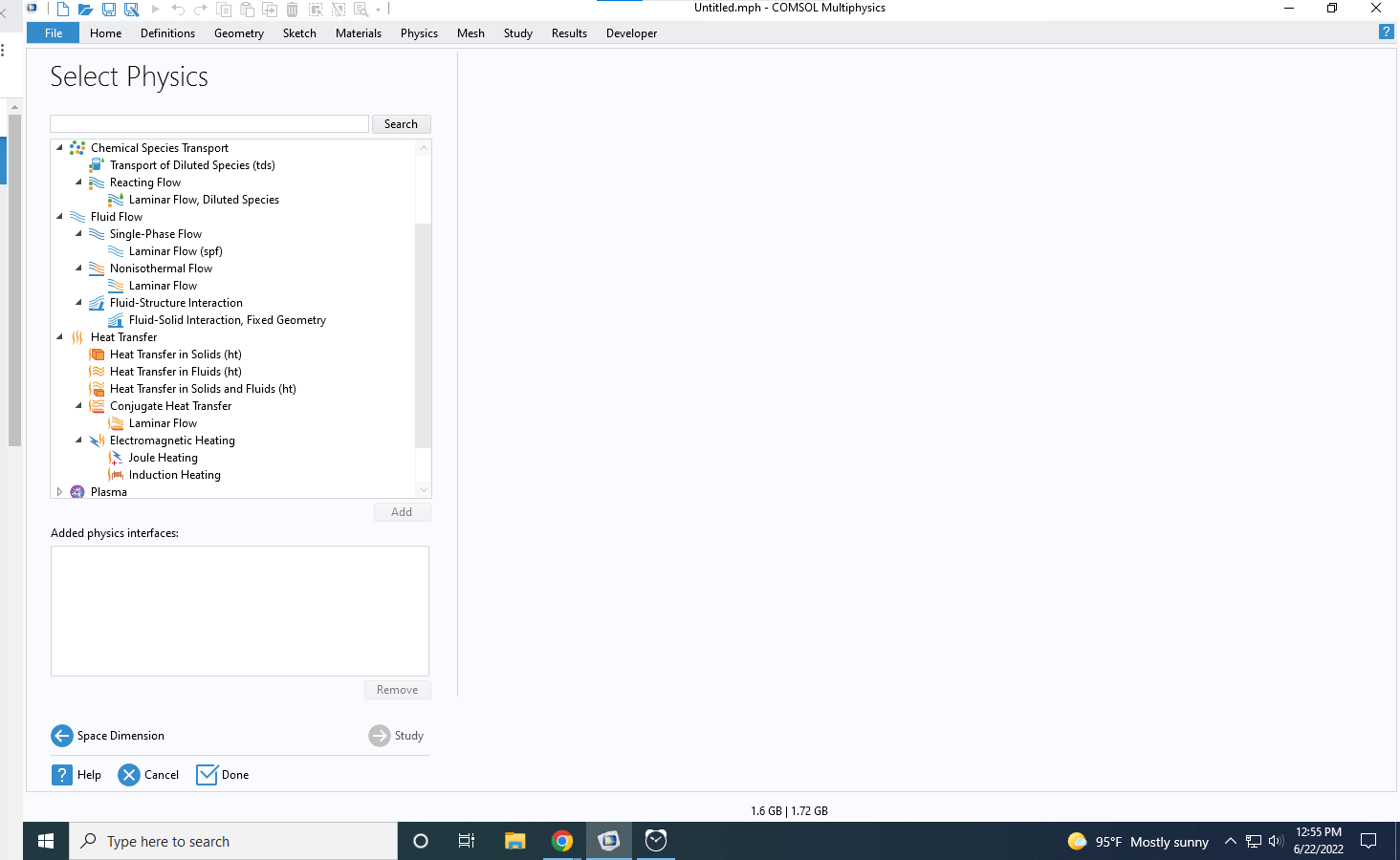

Hello! I am new to Comsol and currently trying to simulate CFD with Comsol 6.0. More precisely, I need to set up the main tube which has 2 side tubes (one carries oxygen and another does nitrogen) and find a distribution for each substance. To clarify what I'm talking about, I've attached the image of the simualtion that I need to set. Although, I do not have CFD module since my university wants me to try to simulate without buying any module if possible. Therefore, I wanted to know if I can possibly to simulate only with what I have or have to purchase other modules such as CFD or Porous Media Flow module. Also, if I can simulate with what I have now, I'd like to know how. I have also attached the Physics that I have now to show which option I can use. Thank you!

Thank you for your replying. I expect the flow to be laminar since velocity would be very small. Even in that case, my guess is that I have to purchase Porous Media Module to simulate multiple chemical substances and find each concentration. Do you think there is any way that I can do those procedures without buying new modules?
