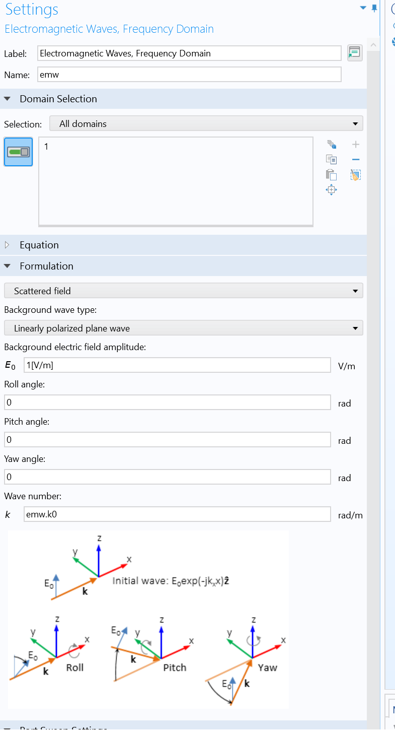

You say that you "applied {an} incident plane wave." Did you use the "scattered field" formulation to do that? If not, then I suggest you try that. See the attached figure for more info about how/where that is to be done. If you have already done that and the problem still exists, then I suggest you upload your .mph file to the forum, to make it easier for the people reading here to help you find the cause of your problem.
