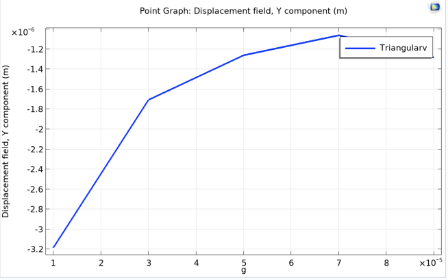

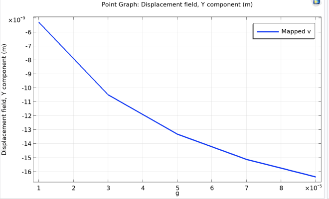

Hello, I am trying to use the MEMS module (or AC/DC Module) to find the effect of electrostatics on the natural frequencies of a structure.
When I use Mapped mesh, I get a result that is way different than the time I am using triangular mesh. Even when I use smaller meshes, the results converge to two very different numbers.
The difference is significant, and I cannot say which answer is correct. Does anyone know what the problem is?
Thanks

Hello, Thank you for your answer.
I did mesh refinements, still different types of meshes converge to different results.
Here I attached the file. Please take a look at the results of two different studies in which each study uses one type of mesh (Mapped or Triangular mesh).
Then the graphs show the displacement for different types of mesh which are very different.
Thanks
>There are a number of possibilities, relating variously to your geometry, mesh, boundary conditions, solver settings, etc. So I encourage you to post your .mph file to the forum so that others can examine it and offer their suggestions. Hello, Thank you for your answer. I did mesh refinements, still different types of meshes converge to different results. Here I attached the file. Please take a look at the results of two different studies in which each study uses one type of mesh (Mapped or Triangular mesh). Then the graphs show the displacement for different types of mesh which are very different. Thanks
