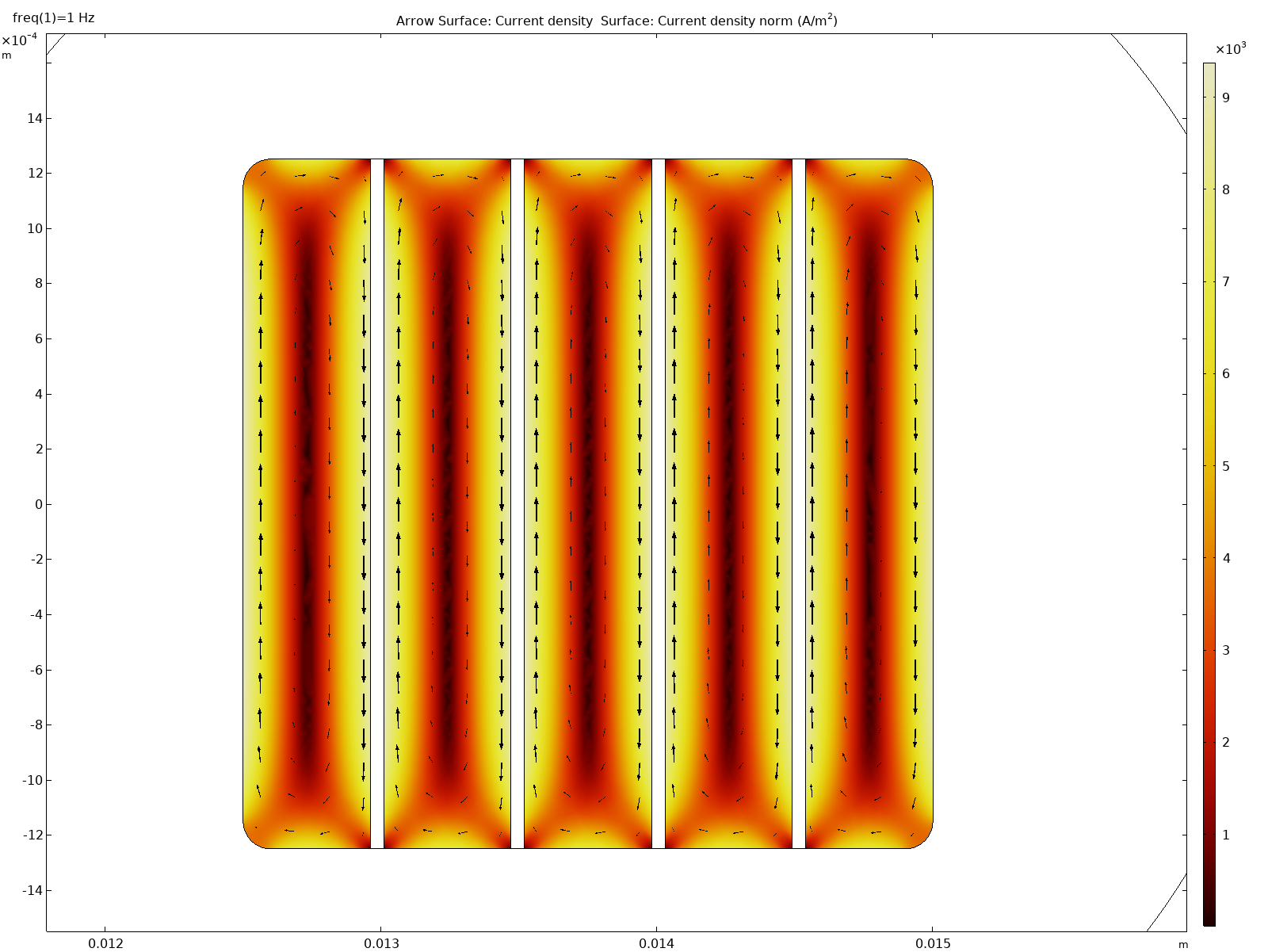

Dear Edgar,
please excuse the delayed response. I expected to get a mail upon receiving responses with "Notify me of replies via email" but something must have went wrong.
You are absolutely correct, the magnetic flux is only in the phi or azimuth direction. The eddy currents on the other hand are in-plane, which is what I am mainly interested in. The goal is to introduce structures in order to reduce the eddy current losses. I did manage to create a model which does show the expected behaviour (see attached figure) but this requires using domains instead of edges, leading to a large number of degrees of freedom.
Best regards Carsten
