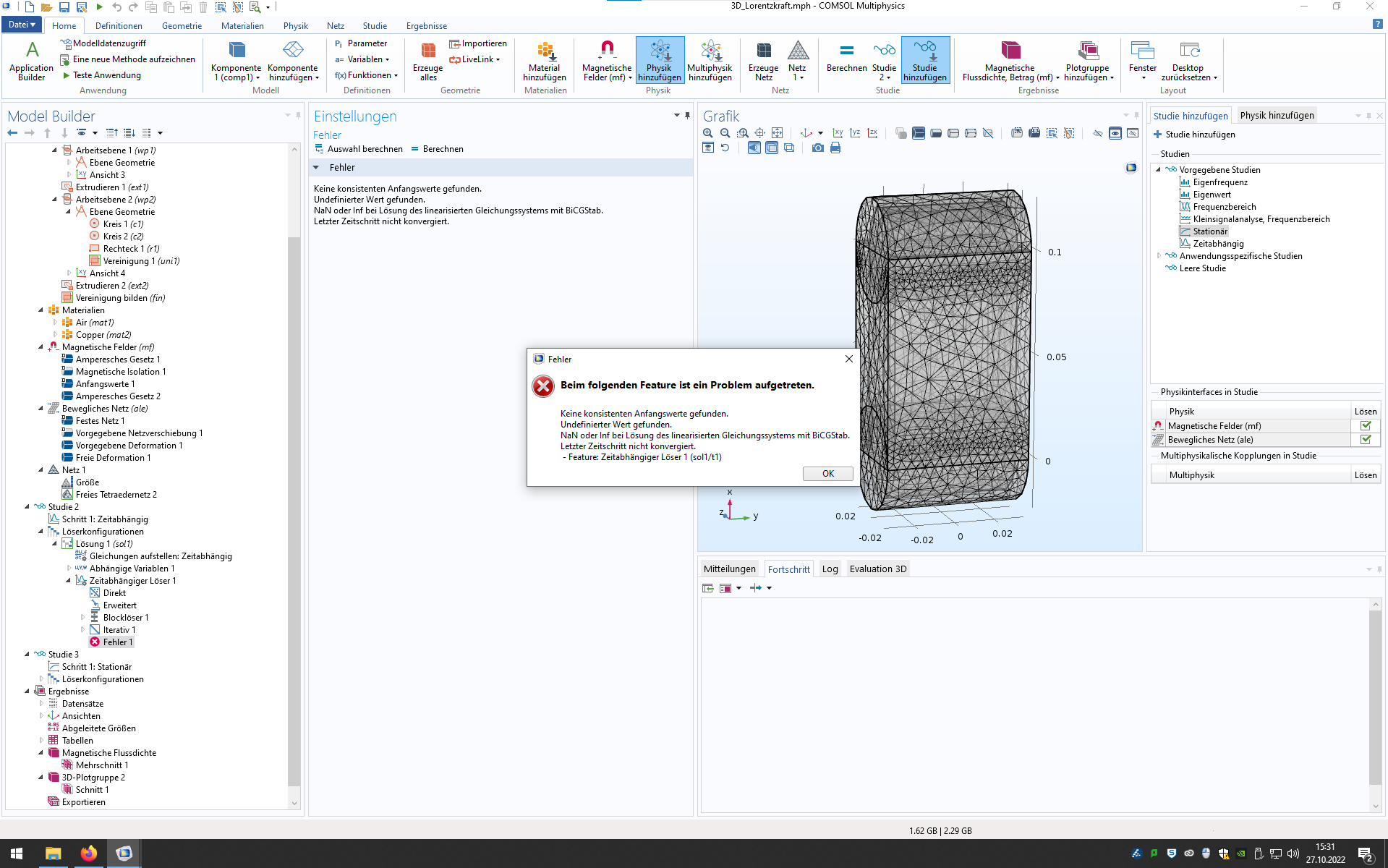

I want to move a conductor through a constant magnetic field of 1 T. How do I create this constant magnetic field?
My solution until now is an ampere law with remanent flux density. I then change the B_r for y until I get 1 T in the middle of my domain. It is not perfect, but it is a solution.
As long as I use a stationary study. When I use a time depentent study, which is of course what I need when I want to move the conductor, I get the following Error (translated from german): No consistent starting values found. Undefined value found. NaN or Inf at Solution of the linearized Equation System with BiCGStab. Last time step did not converge. - Feature: Timedependent Solver 1 (sol1/t1)
So, is there a better way to create a homogeneous magnetic field? Or if not, how can I make the amperes law work in a time dependent study?
https://www.dropbox.com/s/tr7gt3u3nxxhjay/10_27_MagFieldMovMeshError.mph?dl=0
