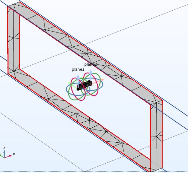

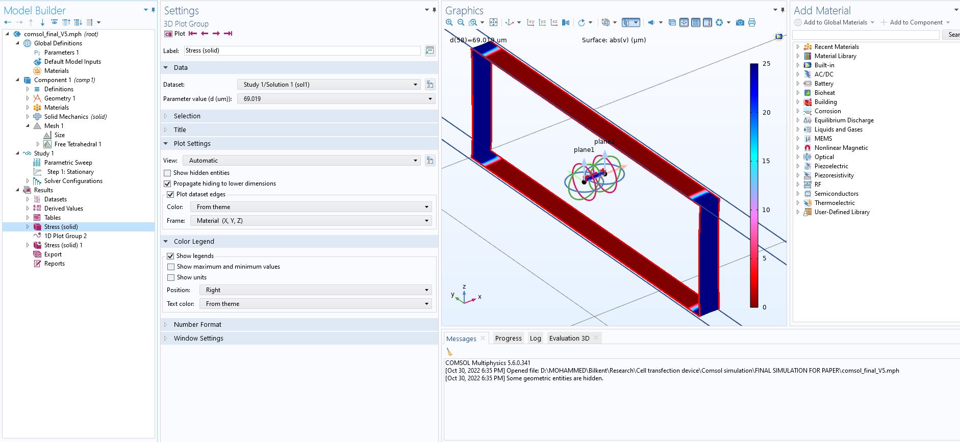

I would appreciate help with the following issue. In my Comsol simulation I am having difficulty finding the solution "inside" the material as the geometry for some reason is presented as a "thin shell". I am attaching my model and a screenshot. I want to see the solution (dispalcement for example) inside the material (couple of mms inside the material) rather than on the faces.

Clip features do not support looking into the volume when applied to plots. I suggest that you instead add a Filter subnode to a volume plot to achieve the effect that you want.
