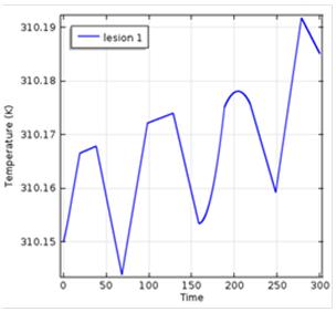

Posted: 1 decade ago 17.09.2012, 11:44 MESZ
Hello Sir,
I have another query. Regarding the temperature profile? Since I am irradiating the boundary using a sin wave. So, I am assuming that the temperature profile at the irradiated boundary should behave a similar nature like a wave. But I am getting temperature curve at a point on the boundary straight lines. It is not following a sin nature. I am using time step of 0.1 for time marching procedure. But I think the temperature profile is not taking all the time steps it is skipping certain points. It is showing irregular straight lines like it has skipped few points. I am not sure what is the problem.
Thanking You
Arka
Hello Sir, I have another query. Regarding the temperature profile? Since I am irradiating the boundary using a sin wave. So, I am assuming that the temperature profile at the irradiated boundary should behave a similar nature like a wave. But I am getting temperature curve at a point on the boundary straight lines. It is not following a sin nature. I am using time step of 0.1 for time marching procedure. But I think the temperature profile is not taking all the time steps it is skipping certain points. It is showing irregular straight lines like it has skipped few points. I am not sure what is the problem. Thanking You Arka
Posted: 1 decade ago 17.09.2012, 15:10 MESZ
indeed it looks like the time stepping is being too coarse, the thing is that by default COMSOL assumes a diffusion type model decay, so when you have a periodic BC you must tweak a little the time stepping settings.
Use rather an intermediate or a strict time stepping (and not the default automatic for periodic BC conditions) then be sure you define enough time steps per periode, 5 as absolute mnimum 10 or more is better (it all depends on the time you ant to wait for the solution ...
Thne you can also consider a gen-alpha, in case of converging issues
Hi indeed it looks like the time stepping is being too coarse, the thing is that by default COMSOL assumes a diffusion type model decay, so when you have a periodic BC you must tweak a little the time stepping settings. Use rather an intermediate or a strict time stepping (and not the default automatic for periodic BC conditions) then be sure you define enough time steps per periode, 5 as absolute mnimum 10 or more is better (it all depends on the time you ant to wait for the solution ... Thne you can also consider a gen-alpha, in case of converging issues -- Good luck Ivar

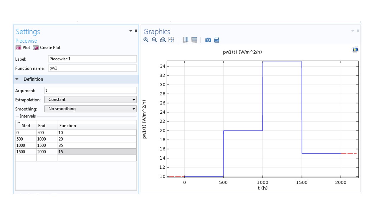

Posted: 9 years ago 03.11.2016, 13:05 MEZ
I have a similar problem. I have to set my convective heat flux depending how much time as passed.
For example;
Time (s) 0-500 set h=10
Time 501-1000 set h=20
Time 1001-1500 set h=35
Time 1501-2000 set h=15
How do I covert this into a IF statement to insert into the "Convective heat flux" field ?
Thanks,
Hi, I have a similar problem. I have to set my convective heat flux depending how much time as passed. For example; Time (s) 0-500 set h=10 Time 501-1000 set h=20 Time 1001-1500 set h=35 Time 1501-2000 set h=15 How do I covert this into a IF statement to insert into the "Convective heat flux" field ? Thanks,
Posted: 9 years ago 03.11.2016, 13:32 MEZ
Make a piecewise function, say pw1, and call it then pw1(t). See attachment.
Lasse
Hi Make a piecewise function, say pw1, and call it then pw1(t). See attachment. Lasse
Posted: 9 years ago 03.11.2016, 16:51 MEZ
Thank you,
I have done the piecewise function, but how are you plotting that graph with h as a function of t?
When I plot the graph I don't get any labels at all.
Thank you,
Lasse
Thank you, I have done the piecewise function, but how are you plotting that graph with h as a function of t? When I plot the graph I don't get any labels at all. Thank you, [QUOTE] Hi Make a piecewise function, say pw1, and call it then pw1(t). See attachment. Lasse [/QUOTE]
Posted: 9 years ago 03.11.2016, 22:30 MEZ
The function set-up window (my attachment) asks for the units of the argument and the function. You must fill in them properly.
Posted: 9 years ago 05.11.2016, 22:34 MEZ
Ok, I got it now, thanks for all the help.
