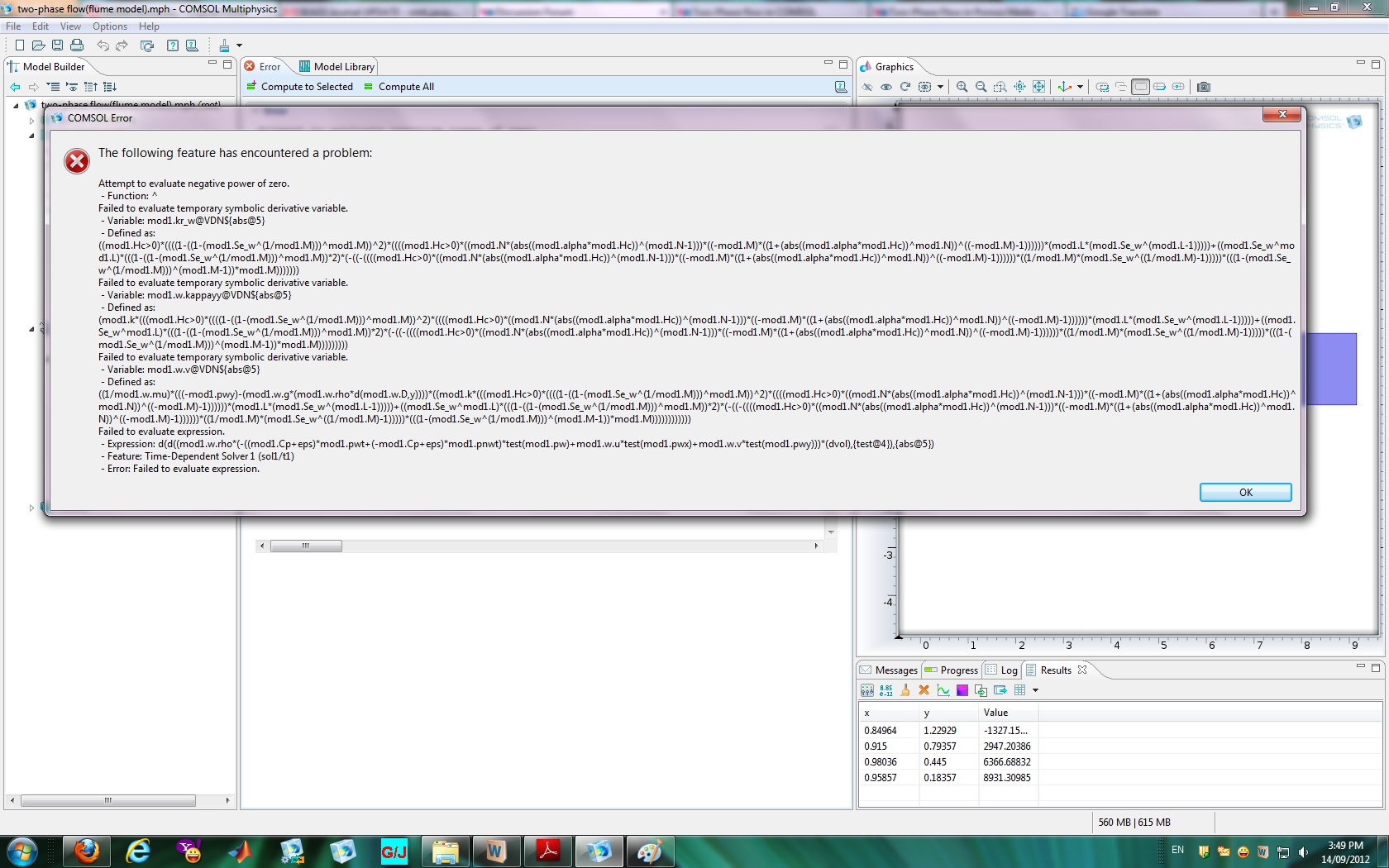

I want to create a model for two-phase flow in porous media. I found an example in model gallery (Model ID:499) which is similar to my model (the example built in version 3.5a but my version is 4.3). I have built my own model like to this example but when I run my own model this error message appeared:
>>>> An attempt to evaluate a negative power of zero (you can see the full error message in the attached file)
I re-checked the expressions that mentioned in the error message but according to governing equation and these expressions we can not have any zeros in denominator anywhere.
I attached my model would you please have a look on that and guide me to overcome to this issue.
