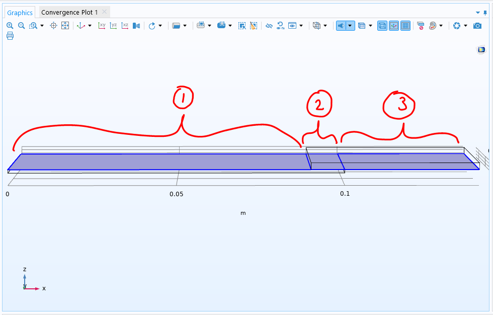

In your model, it looks like you are specifying two different shell thickness types at two different parts of the plate. In the model, I do not see a condition specifying any continuity in displacement where the shells would overlap. One approach would be to instead select three different boundaries for the shell interface (in your model # 4, 8, and 12). Now specify three different thickness conditions for the three separate sections, as shown in the screenshot. In the middle section, the thickness is the sum of the other sections. Each section also needs an appropriate offset defined. Since boundaries 4,8, and 12 in the Shell physics share a common edge, the continuity condition is met.

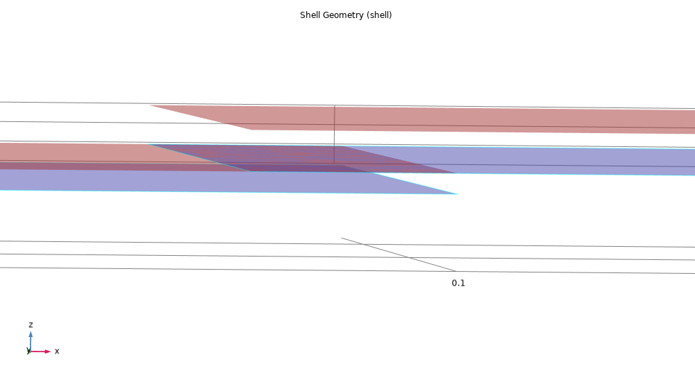

There is an easier way:
Add a Boundary to Boundary connection from Connections at the boundary level in the Shell interface.
However, when working with shells and offsets, you have to be careful about what is top and bottom. Add a Shell Geometry plot from the Add Predefined Plot window to verify.

Dear Henrik,
Thank you!
I have the Shell Geometry plot as the attached image file. I think the setting for thickness and offset are correct.

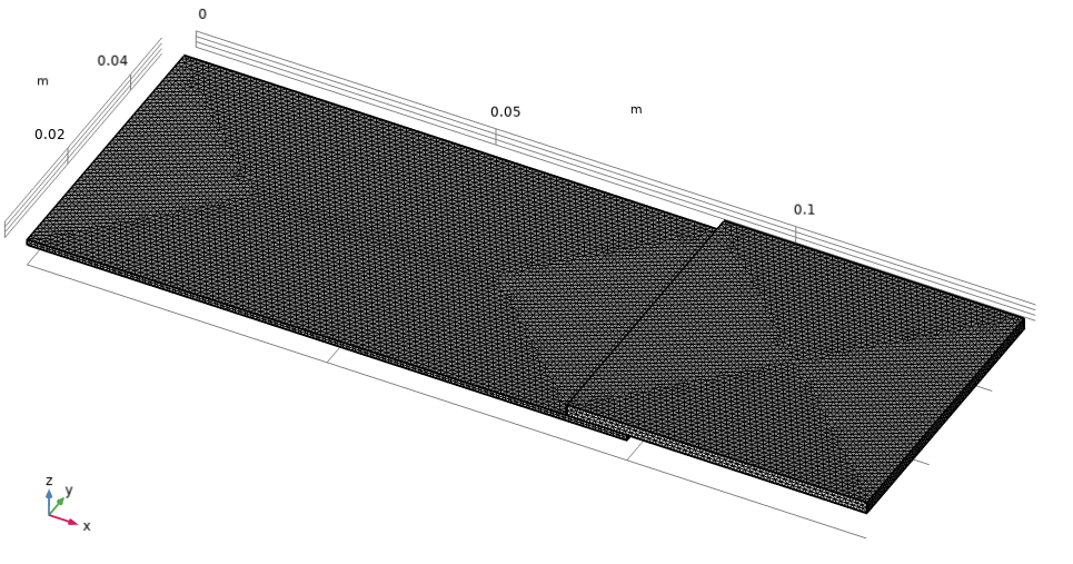

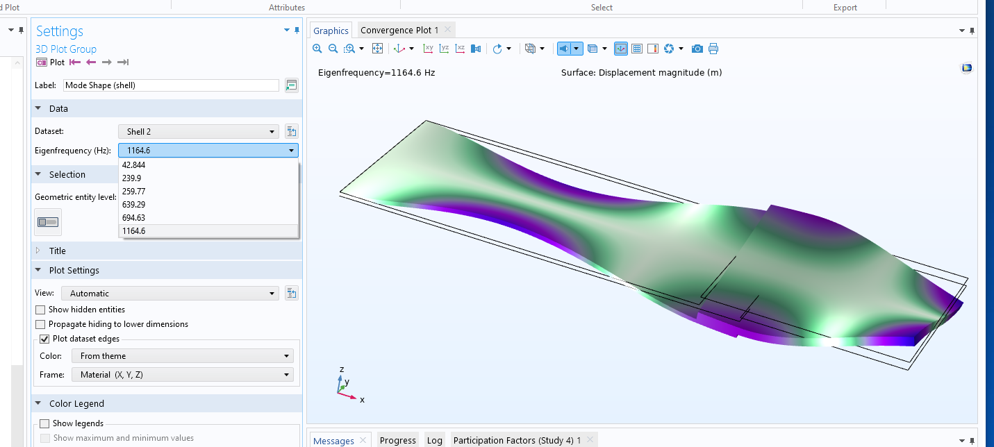

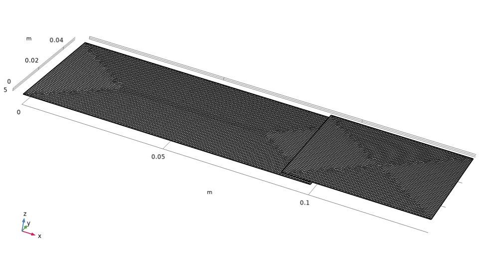

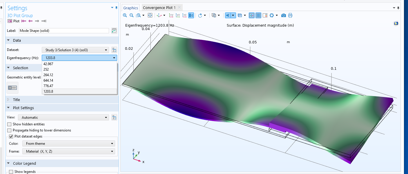

I use boundary to boundary connection suggested by Henrik. Mesh density for solid/shell model is shown in the attached picture. Eigenfrequencies for both models are in good agreement. Is the increasing discrepancy against frequency an expected outcome for using shell? The bending curvature is steeper for higher eigenfrequency for which shell approximation is degrading. Is it a proper interpation?
