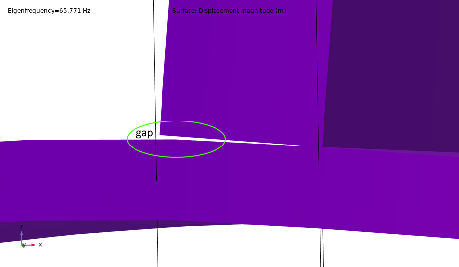

When I zoom in for a mode shape, a gap betweem the vertical and horizontal plates can be seen. Is it just a visulaization "artifact"? The image file is attached.
Thank Henrik! Yes, I did swap the thicknesses in the second model. The result is okay now. When I zoom in for a mode shape, a gap betweem the vertical and horizontal plates can be seen. Is it just a visulaization "artifact"? The image file is attached.

Yes, it a visualization artifact. The shell is drawn as a solid by extruding it along the direction of the normal.
