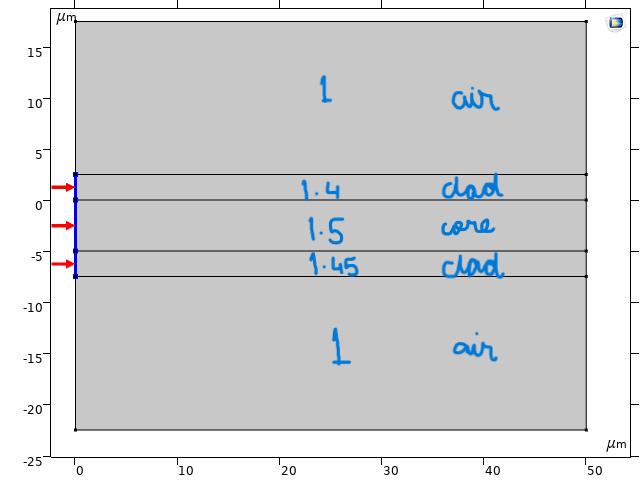

Hello. I wanted to ask about excitation of a waveguide using numeric port in wave optics module. I have seen that while exciting, the core and cladding need to be selected as port boundaries. Why is that ? Does exciting only the core not result in guided wave ? How does COMSOL decide which is the core and which is the cladding and hence guide the wave properly?
(I have attached an image describing the situation)
