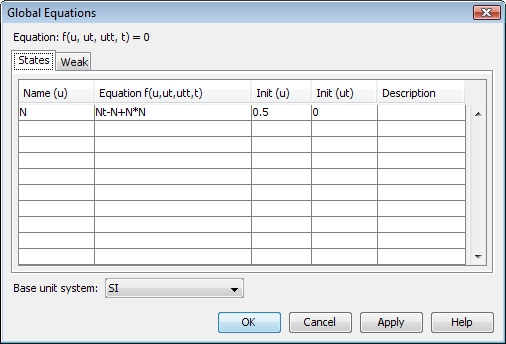

suppose my equation is logistic growth equation
1. ok
2.ok
3. ok
4. go to physics menu > global equation : field 1 name(i wrote, N), field 2 equation (i wrote, dN/dt= N(1-N)), field 3 init N (i wote, 0.5) , field 4 init Nt (i wrote, 0)
is it ok?

In step 4, correct your equation: it should be
Nt-N+N*N
, as Nt means derivative w.r.t. time and you have to enter the expression which is null-valued.
In step 5: after selecting only ODE, press OK.
In step 6: select your times and press OK.
Step 7. Press the SOLVE button (symbol "="), or in Menu > Solve > Solve Problem.
Try these steps, please.
Jesus.

it gives error
duplicate variable
N
Nt
Ntt
n
Nt
Ntt
variables are repeated?
for step 4
Name (u) equation f(u,ut,utt,, t) init (u) init (ut)
N Nt - N + N*N 0.5 ?
please correct if wrong.
regards
Good weekend.
Jesus
the similar i did. but error duplicate variables. how to handle it?
