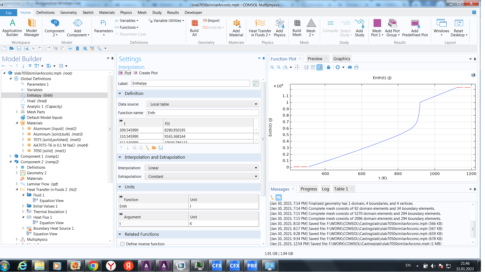

I have a big expirience for modelling casting process in other softaware (like Ansys and Procast) and in this year I started usefull (tested) Comsol. COMSOL I think will be most universal package at nearest time but i have a some troubles for correct modelling alloys with wide solidification range, for example Al-Zn alloy with 7-9% of Zn where is solidification temperature range ~ 70 C. For this case not possible to use Hidden melting heat for jump during 1 degree of Celsius as for pure Aluminum and I need to define precise function for Enthalpy or Capacity for all temperatures for solidification range. Best way for that - use Enthalpy function directly, and which we can define by Function (Interpolation) from txt file obtain by Calcosoft Procast for alloy. But, I not uderstand possible or not to use Enthalpy formulation for heat mass transfer in COMSOL, or only Heat Capacity formulation is available? I tried to import enthalpy curve from txt file as Function(interpolation) with name “Enth” and after that make a new function which is a differentiation of Enth by temperature. In the field Expression of new analytic function I define the d(Enth,T) and argument T in the bottom field. But it does not working, Comsol not understand the name of function “Enth”. Is possible to use d(f,x) for differentiation the functions? Or I must to prepare txt file with Heat Capacity curve by another packages which will give me the differentiation of Enthalpy curve? As well I have additional question Is possible to define temperature interval (by function or another) in the field Phase Change interface – Phase change temperature and Latent Heat in neighbor field?

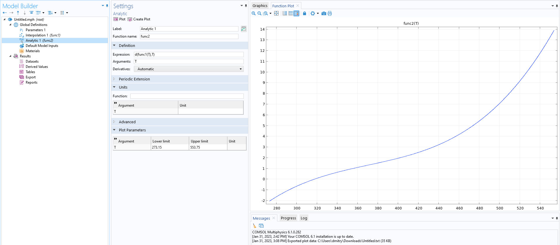

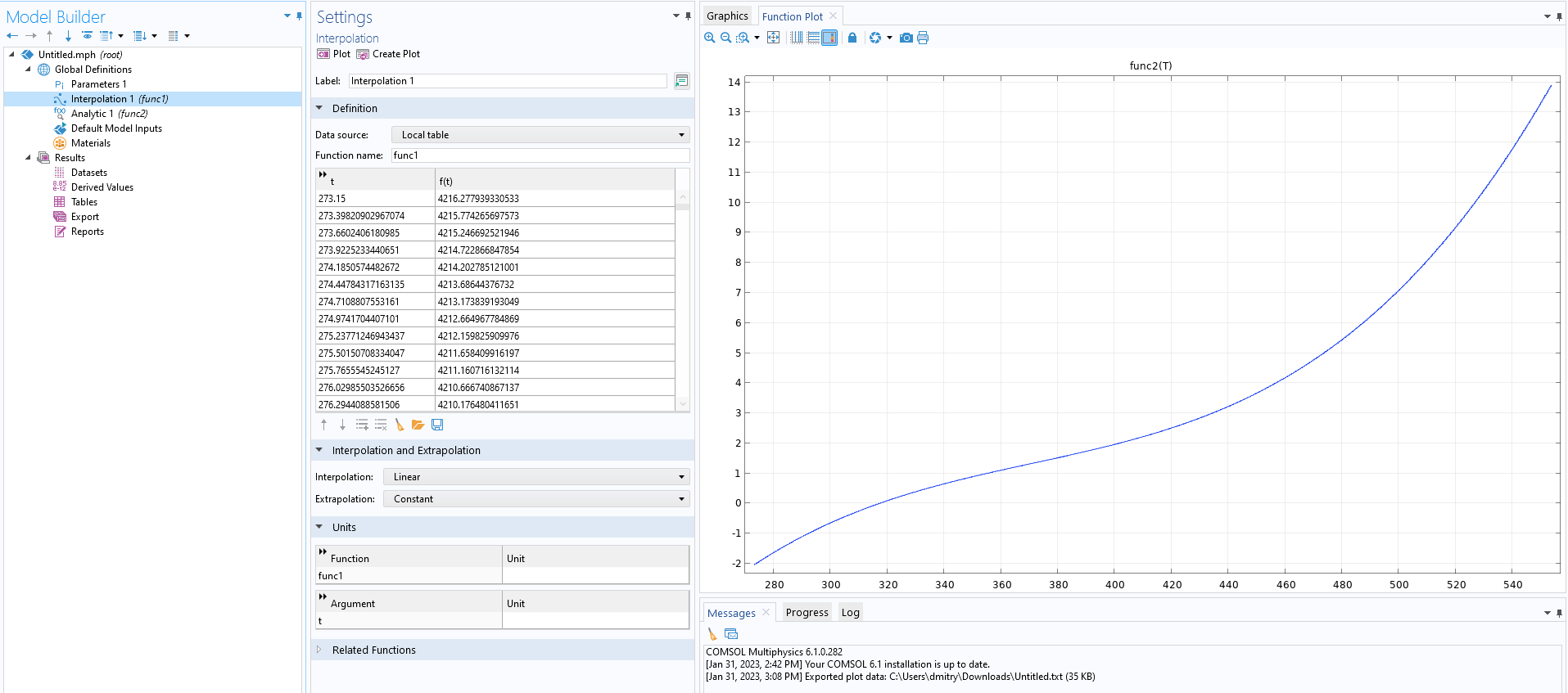

Sure. To demostrate this I've created Interpolation function func1(T) (see Screenshot_1.png) and Analytic function func2(T) = d(func1(T),T) (see Screenshot_2.png). As you can see the diffirentiation operator works.

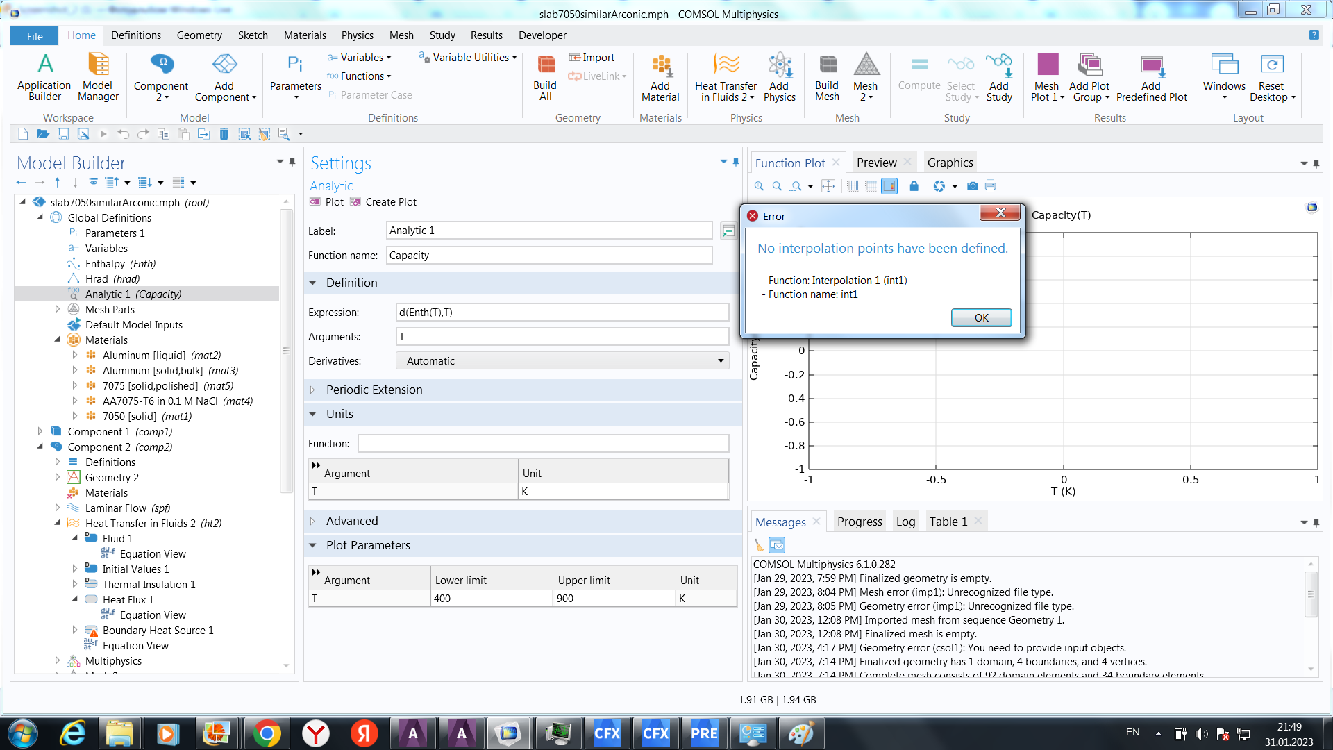

1.I have cheked the d(Enth(T),T) on your manner, but can't to recive normal derivative function. Please see the my prinscreens, the results is negative for both cases - when i input the unit dimensions - J, K for Argument and Function fields and without it (similar to your example). Please check, maybe i have a too much points in initial Enthalpy .txt file and remove for this first 5 row.

After upgrading from Win7 to Win10 the operator d(Enth(T),T) stared working. Can i use integrate operator for function Cap (T) = d(Enth(T),T) for cheking and compare with initial function Enth (T) ? Can i define this analytical function in global definition? I tried the function integrate(Cap(T),T) but it is not working at Global Definition and Point Eveluation in Results.
