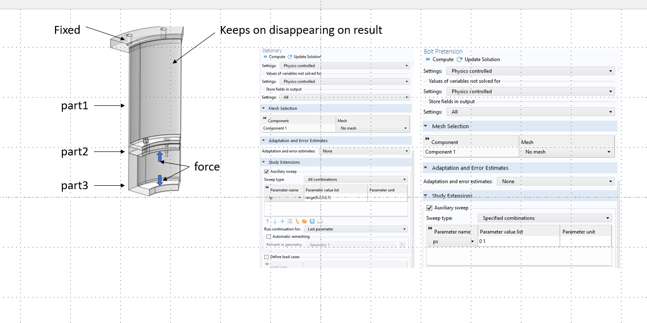

Part 1 does not show on my result. the only stress I can see is from bolts and bolt contact area. My expectation was to see stress from part 1 as well as part 3.
I have no clue about why I don't see any stress from part 1 and 3. Would anyone please help me with this?

The first thing to look for when something seems to be missing is if you have some unwanted hidings in a View node. A fast way of finding all such occurrences:
Ctrl-F and search for 'hide'

Thank you so much. I realised I did not include the domain in my solid mechanics setting.
