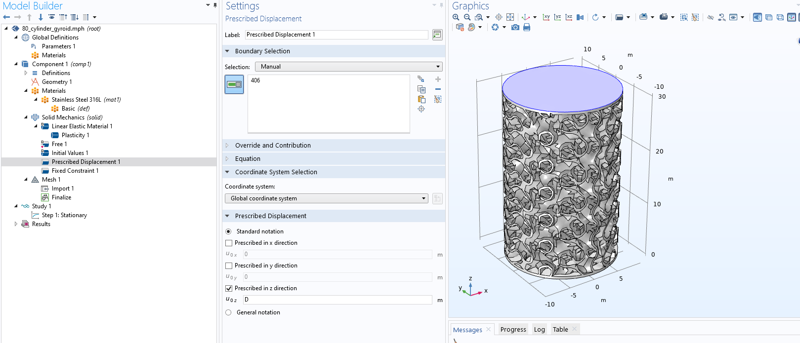

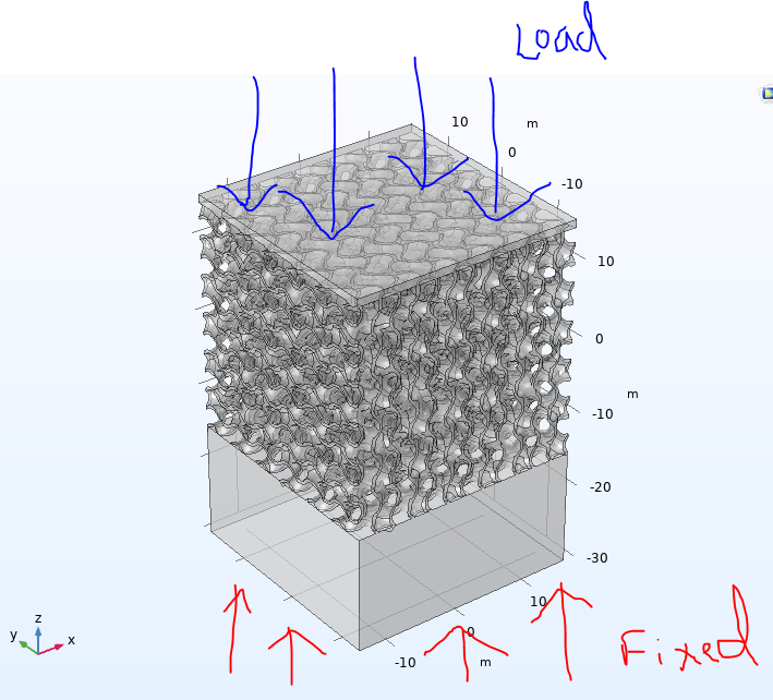

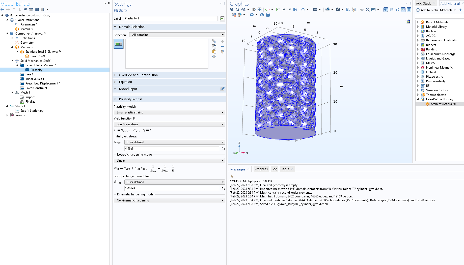

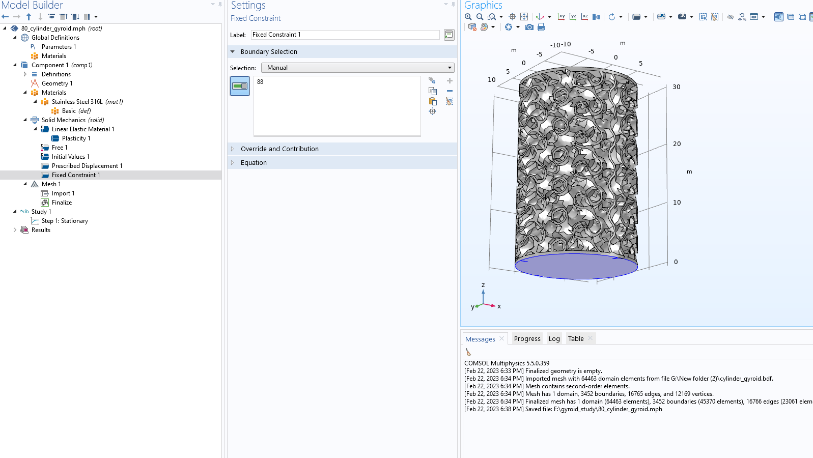

                                                    Hello Jeff,
Sorry for the late reply. I made some tweaks to the model and fortunately i was able to get some part of the deformation curve.  But, i am still struggling to get the densification region in the stress strain curve once the lattice has been compressed to 60 per cent of its length. Does COMSOL have this feature or am i doing anything wrong?
I am not able to upload the model because it exceeds the file size limit. i am attaching the screen captures of the boundary condition and material properties that i have defined for the model. Also the generated stress strain curve.
                            Hello Jeff,
