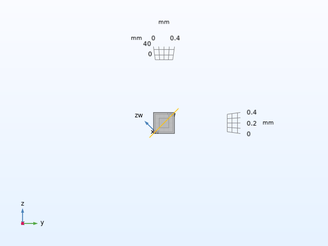

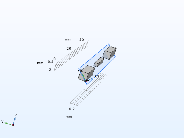

I have a rectangle model that reduces its thickness by half at the middle of the length and then increases to normal size again. the dimensions are as follows
0.4 x 0.4 x 10 mm starting at z=0 (large rectangle)
0.2 x 0.2 x 10 mm (small rectangle) (small rectangle is not at the z=0 but is at the middle of the large rectangle, it is placed at z= 0.1-0.3 mm)
Basically, the total length is 50 mm as;
10 mm large rectangle + 10 mm transition zone + 10 mm small rectangle + 10 mm transition zone + 10 mm large rectangle.
But due to the height difference of the small rectangle, the plane has to be angled, I could solve the issue, and any ideas would be very useful.

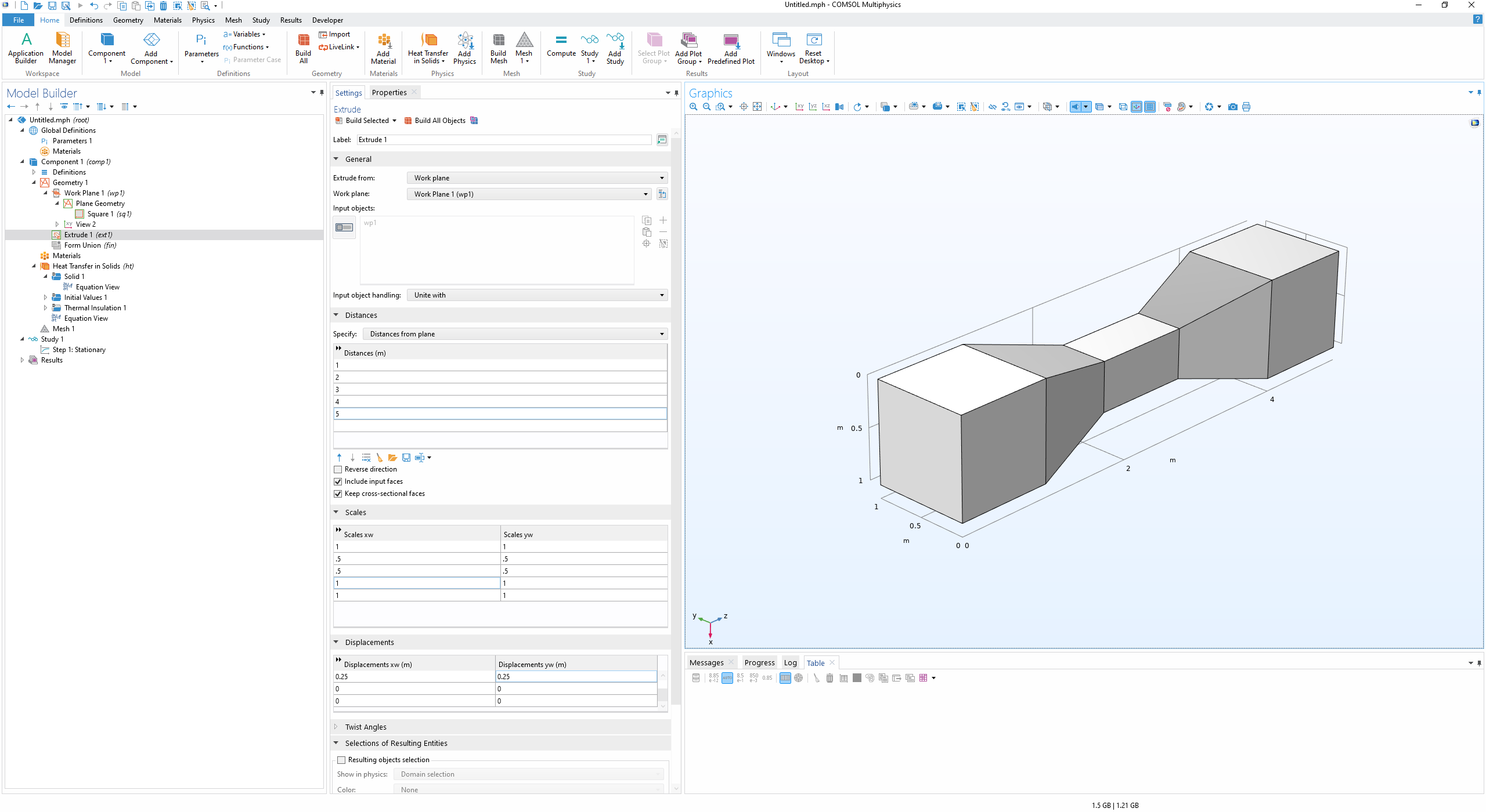

Hello Ibrahim,
You can achieve this by drawing a cross section (here, a square) in a work plane and then using an extrusion with scales, as shown in the attached files.
Jeff Hiller
Hello Ibrahim, You can achieve this by drawing a cross section (here, a square) in a work plane and then using an extrusion with scales, as shown in the attached files. Best, Jeff
