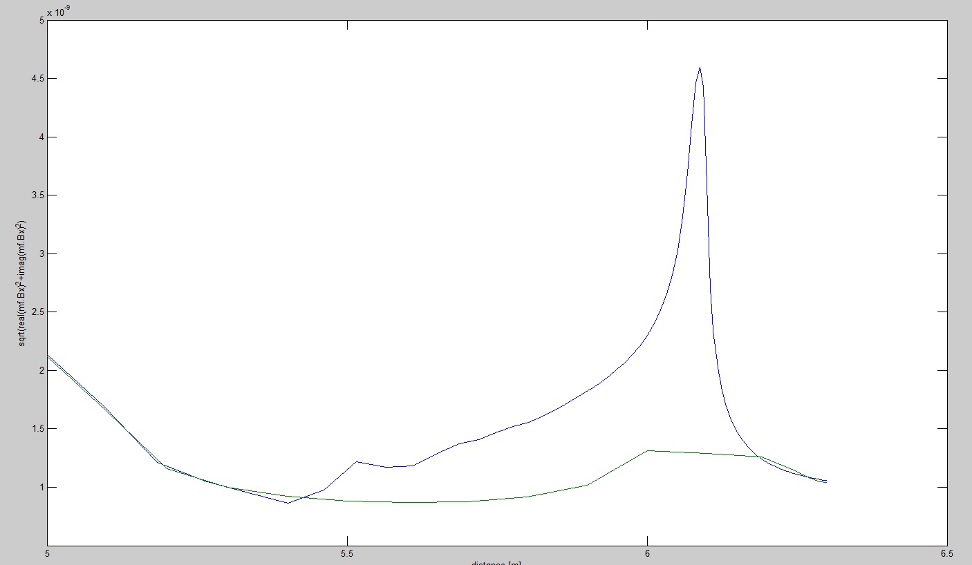

EDIT : I do that. I upload an image plotted with matlab, comparison of defect-no defect, for Module(Bx) in function of x.
I don't understand why module increase at 5.5 meter in defect simulation.

do not underestimate the complexity of even a "simple" simulation, there are many things to think of. If you work in frequency domain you must also define the frequency in the harmonic solver node, and estimate the corresponding skin depth manually as the AC field will not enter into the aluminium material much further than a few "skin depths"
To plot the real and imaginary parts, you need to use the real() and imag() operators in the plot expressions
Fillet is an option of the geometry, you select the points where you want the radius to apply, make them realisitic w.r.t. the meter large model you have, or is there a scaling effect I missed ?
the EM field will concentrate on the edges and the vertex, as you have sharp edges, you get strong fields locally and shielding effects that make the observation of your air slot, less than "evident".
You could test it out on a simple Al (foilleted) rectangle with a round hole in the middle, which is simpler than your L bracket beam profile
You do not need to go to matlab to plot line curves, you can do that either on your edges (boundaries) or on Data Set Cut lines you might define
