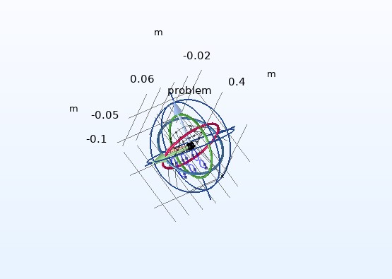

How do I exit this view?
I am stuck in this problem view, how do I exit it?
Thanks for helping

Hello Thomas,
If I understand your post correctly, you' ve added a clipping sphere that you no longer want. It that understanding is correct, click the "Clipping" button (located at the top of the Graphics window) and delete the clipping sphere in question. Alternatively, you could delete (or disable) the clipping sphere node in question in the Model Builder (under Component>Definitions>View).

Hello Thomas,
Hello Jeff,
The problem solved! Thanks for the help.
