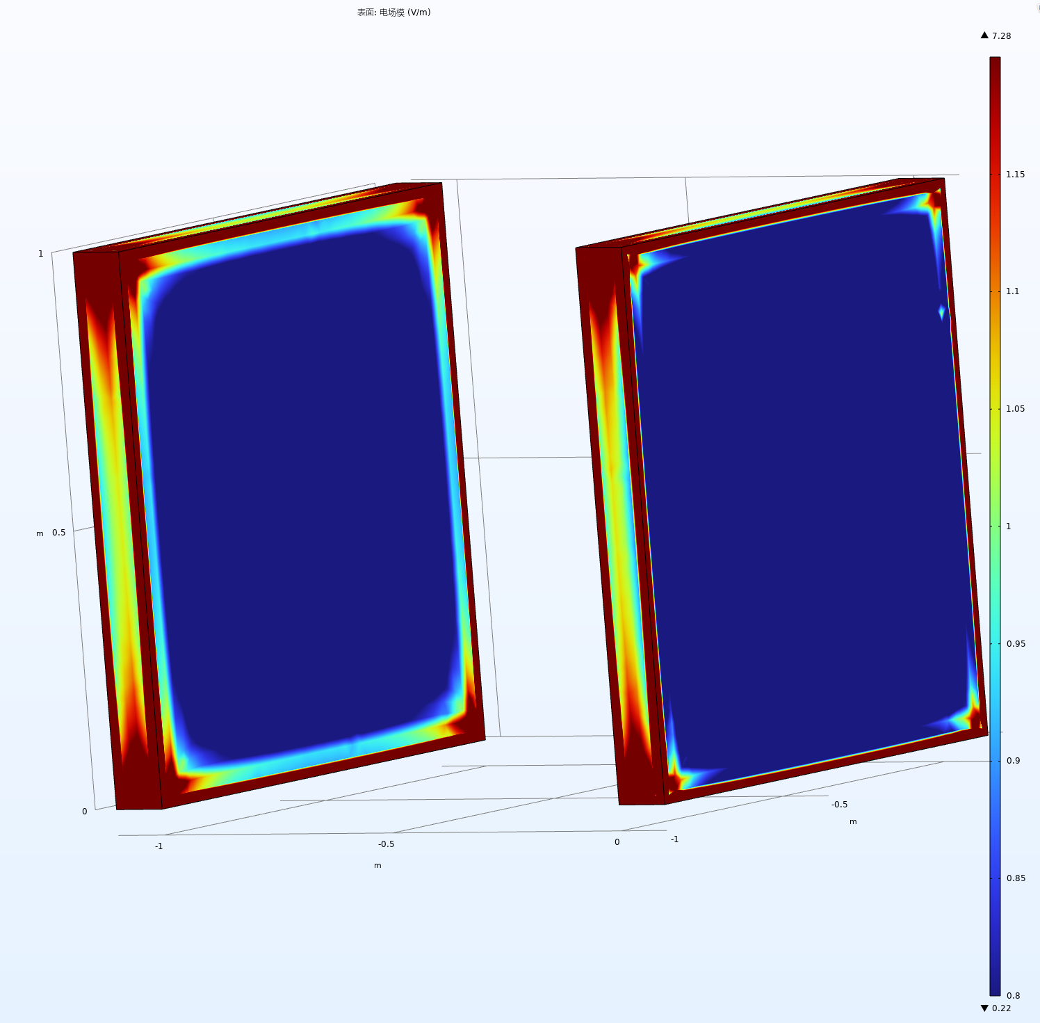

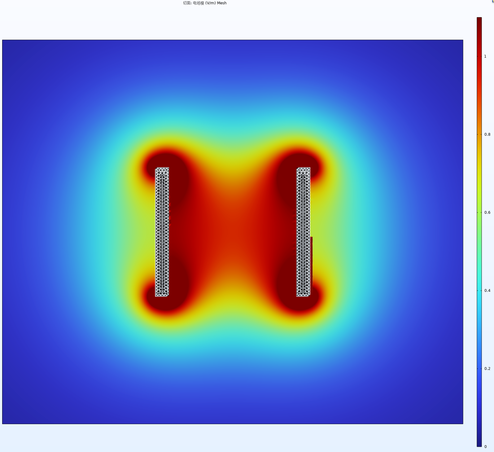

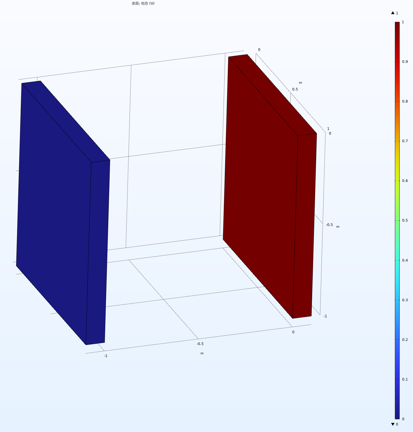

The electric field strength at surface is different from that in the air domain acc. to AC/DC BEM results. Around 1 in the air domain and 0.5 at conductor surface.
How to set to make these two results matach? Since I don's care the transition of the electric field strength from conductor to air, the max. value is actually what I need.

However- if you evaluate a quantity at a surface- without specifying upside or downside- Comsol computes the average.
As usual, can't say anything definitive without the .mph file. However- if you evaluate a quantity at a surface- without specifying upside or downside- Comsol computes the average.
