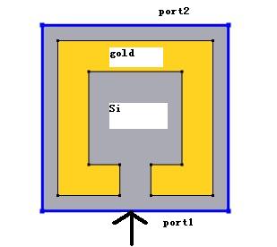

I have some problems when making the model. I have a split ring resonator on the Si substrate. A beam of light is incident vertically on the ring. I use the ports and want to calculate parameters S11^2 and S21^2.
To the substrate ,the electric displacement field model should be relative permittivity or refractive index? In the port mode settings, I set E0x=1 and other two components are zero. The propagation constant is k0. I use wavelength of parameter sweep.
The result is that S11^2 has the lowest point and the S21^2 has the highest point. It is contrary to the theory. I can't find out the problem.
Hope you can help me!
