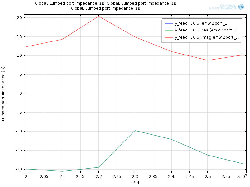

Hi Robert,
I used the global result emw.Zport_1. And things get even stranger when I look at the complex components. Here is what I sent to COMSOL support as well:
It looks like emw.Zport_1 actually returns a (wrong) real part only. One example at a specific frequency:
emw.Zport_1 = -10 Ohm
real(emw.Zport_1) = -10 Ohm
imag(emw.Zport_1) = +15 Ohm
emw.Zport_1 should be sqrt(real^2 + imag^2) = sqrt((-10)^2 + 15^2) = 18.02
Surprisingly the results are the same when I calculate the impedance and its complex components form emw.Vport_1 / emw.Iport_1.
According to the definition the absolute value of the imdedance cannot be negative and I always presumed that emw.Zport is defined as the absolute value of the impedance. I assume this is a bug in COMSOL.
I attach the impedance plot. Please note that the blue and the green line are on top of each other.
I appreciate your input.
Best regards
Edgar

Posted: 1 decade ago 05.11.2012, 15:41 MEZ
Just a little update: The problem could be resolved with the help of COMSOL support. The reason was an accidential wrong phase setting in the solutions.
Now the model and measurements are in good agreement.
Cheers
Edgar
Just a little update: The problem could be resolved with the help of COMSOL support. The reason was an accidential wrong phase setting in the solutions. Now the model and measurements are in good agreement. Cheers Edgar

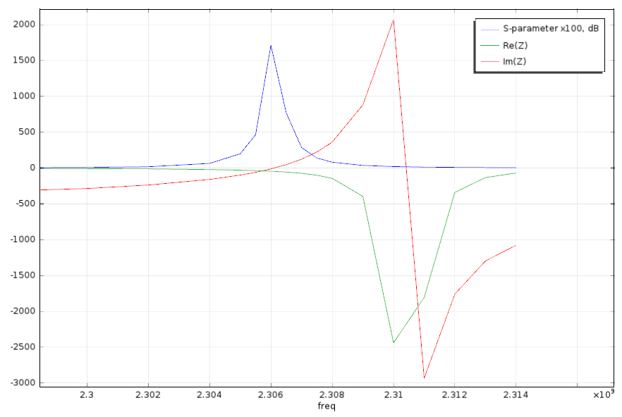

Posted: 1 decade ago 04.01.2013, 17:44 MEZ
Hi Edgar,
I'm experiencing the same problem simulating an Alderman-Grant-resonator at ~2.3GHz.
The imaginary part of the frequency-dependent impedance behaves as expected. The real part gives a symmetric peak, as expected, but with negative sign. Correspondingly, the S11 parameter shows a peak with positive values.
Could you tell me where to find that phase setting that solved the problem in your case?
Oliver
Hi Edgar, I'm experiencing the same problem simulating an Alderman-Grant-resonator at ~2.3GHz. The imaginary part of the frequency-dependent impedance behaves as expected. The real part gives a symmetric peak, as expected, but with negative sign. Correspondingly, the S11 parameter shows a peak with positive values. Could you tell me where to find that phase setting that solved the problem in your case? Best regards, Oliver
Posted: 1 decade ago 09.01.2013, 14:55 MEZ
Hi Oliver,
In my case the problem was that the 'solution at phase angle' was set to 90° in some of the solutions. Setting it to the default value 0 resolved the problem.
Cheers and HNY
Edgar
Hi Oliver, In my case the problem was that the 'solution at phase angle' was set to 90° in some of the solutions. Setting it to the default value 0 resolved the problem. Cheers and HNY Edgar
