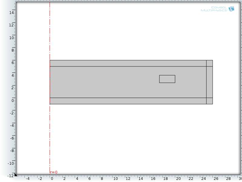

I would like to find the resonances of a ring resonator.
I used a axisymmetric model (2D) with eigenfrequency analysis.
The materials are air and a polymer for the ring.
I put the PMLs but the solutions don't correspond to the confined modes that we expected.
Is it correct what I did?
Can you give me some advices?
The geometry is below.
Thank you in advance
