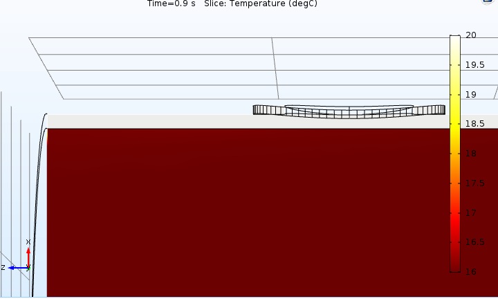

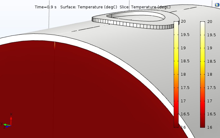

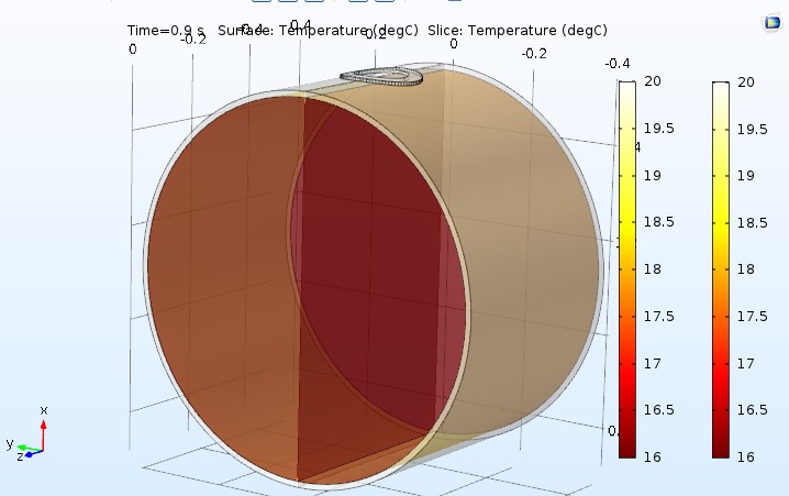

Posted: 9 years ago 27.02.2017, 18:18 MEZ
i attach pic for my project, you can see thickness not influance with fluid temperature i dont know why?!, any ideas?
i form an Union in geometry
i attach pic for my project, you can see thickness not influance with fluid temperature i dont know why?!, any ideas? i form an Union in geometry
